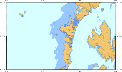

An aspect that is almost never considered when comparing paper with electronic ones is the physical size of the image. (Edit: Baggywrinkle did touch in it).
Who has a screen with super high resolution which is about a metre square? It would need to be that big to compete with a paper chart's functionality (even if the reliability and power requirements were equal). If I had such a screen, electronic charts would be just fine by me, but on a tiny device like a mobile phone or even a chart plotter it's hard to see both detail and the bigger picture simultaneously. So you 'pinch zoom', with the result being no real appreciation as to whether the area covered is now the whole Atlantic Ocean or just a minor creek in Chichester Harbour! So it's not impossible to go all electronic, but it is error prone for that reason.
I think the way forward is to print a chart of the area you want to explore before setting off. I've certainly done that for voyage planning, printing A1 or A2 sheets of where I plan to be. "Not For Navigation" perhaps, but jolly good for the overall picture. You can upload a pdf file and get next-day prints by post from several web sites. That the UKHO can't do this is why they are of decreasing international importance; just about everyone else, including the Americans, can. Besides, if only for planning purposes it's frequently possible to use open databases of shorelines, bathymetry and land topography for which you don't need any HO.
Here is a tiny section of one such (printed to be 30cm across; I'd normally make it more like 100cm across but that would make it too big to be a ybw attachment). Typically I aim for 1:200,000, or there abouts. I'd use such a chart for planning a trip to St Kilda, but not perhaps for transiting the sound of Harris! It's all public domain data, and that data covers the whole globe (In case Antarctic Pilot reads this, I printed such a chart covering the Antarctic peninsula which was excellent - probably he created the data base!).newmap-3.png

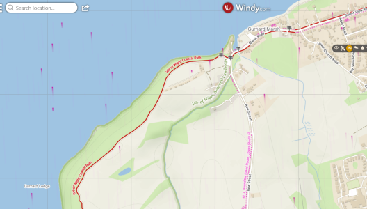

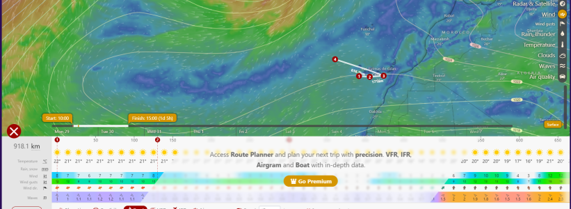

Talking of which.. I've gone over to windy.com now for the initial passage planning & imho is really useful, saves on favourites & you can actually put in speed decimals by hand though it just saves integers. The weather model display can be changed but think maybe the calcs table is fixed to ecmwf.
But great for "if I leave at 10 & do 4Kts when will I be off Big Bay.." sort of thing. So quick to try different scenarios. Even tells the weather 😊

Looks handy, do you have the paid version?
Zoom in on Windy and you also have an excellent road and street map.

@GHA is that the premium version ? Is it worth the £20 approx a year ?
just tried it not logged in & it seemed to be the same, give it a go. I am premium, living on the hook I use it so much every day seemed just greedy not to give something back.
edit > seems they put a banner up if not premium. So in my case definitaly worth going premium just for that 😎
