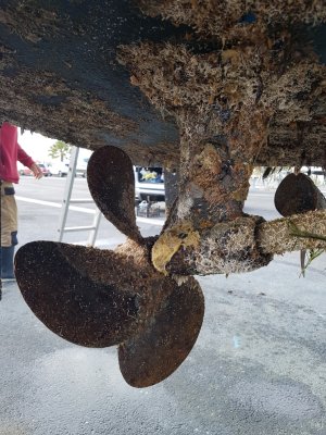

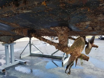

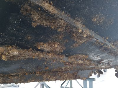

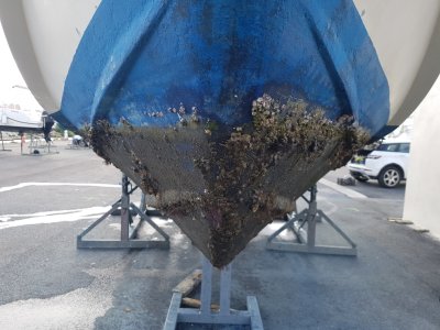

The boat got lifted out today.
I think forum wisdom is going to be proven correct.
It is clear that the owner does not believe it is the cause of his problems so hopefully he is in for nice surprise.
Resize_20230512_130441_1657.jpgResize_20230512_130441_1273.jpgResize_20230512_130440_0878.jpgResize_20230512_130439_9009.jpg
The small amount of antifouling that is visible in the first photograph looks very rough
Perhaps its time to strip the old antifoul and start again.
Seen lots worse that on a hull.
Unless the owner is super fussy and has time and money to burn, a good jet wash and nice new new coat of anti-foul will sort that hull.
Fouling on the sterngear is the real problem and more specifically the crud on the prop blades.

On arrival, a volunteer from the local diving club was summoned to access the problem, the hull was OK ish but the prop blades were smothered in barnycules and coral.
20 mins with paint scraper soon sorted that.

Just got back from post scrape and paint sea trial.
What a difference.
WOT 3700
Top speed about just ovet 40kph.
One happy frenchman. (owner)
Very bow up. The flaps were not working ( now fixed.... blown fuze).
So should do better next time.
There still some black smoke. Could this be residue thst has built up in the engine burning off?
Thanks for your views..... which seem to have been spot on.
