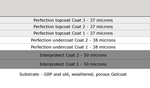

I’ve just read your wonderfully detailed write up. My Albin Nova has the same deck style, with the moulded in anti slip (and cracks and pinholes). I’ve been considering painting it, now I feel like I really ought to.
It is very rewarding. The best bit is the high build InterProtect going on and seeping into all those pin holes and cracks and watching them melt away. It did nearly kill me though doing the work!!

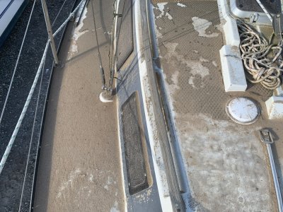

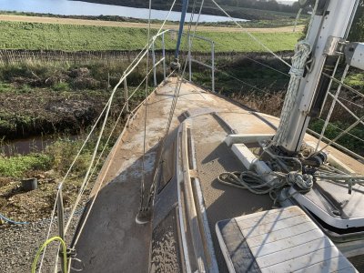

I’m about 3/4 of the way through the stripping process now, using the mild weather while it lasts. I’ll probably settle for using an International Prekote & international Interdeck finishb as suggested by Tranona. & others.IMG_1191.jpegIMG_1194.jpeg

The results were all down to Internationals awesome products really. I had never painted a deck or used two pack paint before, so I was far from professional. The paint is incredible stuff, especially the self levelling properties of it!
Good luck and just you wait, by spring she'll look amazing. Courage will win out - removing all the deck fittings is about as alarming as it comes. I had some dark moments when I thought I had bitten off far more than I could chew, but it was all worth it in the end.
