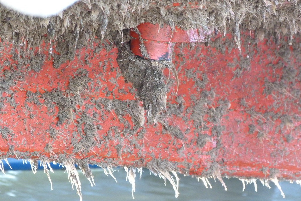

Never used anything on mine .... if it stops working ... usually a twist in the mount and back again gets it working again.
When I lift out ... sometimes many years staying in ... unit is still relatively clear ..
I don't think you could say the same in the Mediterranean. Even with Velox the tube worm needs to be scraped off monthly. Without it my log impeller will stop rotating in around a week if at anchor throughout.
