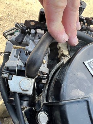

What would cause fuel to spray out of the two brass pipes on top the carb? It’s coming out at quite a rate.
It’s a mercury 6hp 4S with a brand new carb as the original had been mullered by the previous owner.
I had it running nicely in the bin at home tho the plug was getting very black/oily in no time at all. Tried it on the water today and it wasn’t great, ended up with a lot of rowing.
Chris
chris-s
24 Apr 2019
714
Nothing was on the pipes. On previous engines with similar/same carb they just have short pipes leading’s inside the cowling to drain but I have never seen them spray out the amount of fuel this was doing earlier.

Needle valve. Probably was installed crooked. Easy fix.
Also, if the fuel tank is pressurizing that can contribute. Install a cut-off valve, or better, a demand valve (Attwood sells them).
Some models take the vents into the intake before the carb. You can also put a lawnmower fuel filter on them to reduce evaporation and gumming in the carb, and keep bugs and dirt out. They really should at least have a screen.

Think it might have been the float needle, with the float right up it wasn’t shutting off. It was overflowing on priming, not sure how I didn’t notice that after fitting it the other day. A slight tweak and it doesn’t overflow and the plug seems cleaner after a comparable run in the bin. Will try it in anger tomorrow.
Thanks!
