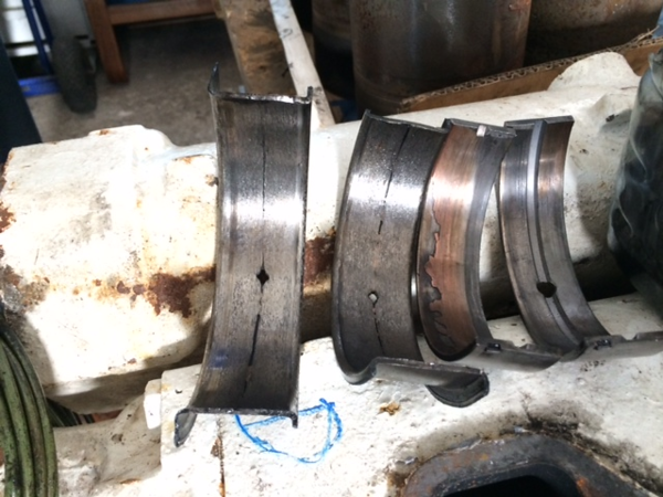

On some, the bearing was melted in its seats, so that the seats of the piston rods are now out of tolerance.

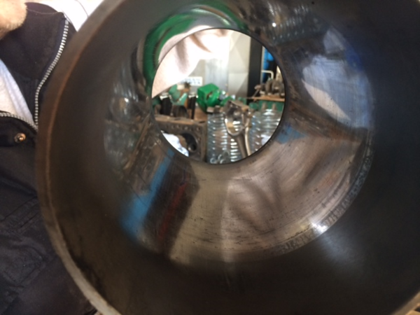

Then Ilko found out that there is much wearing on the liners surface, it doesn’t have any groove pattern in it anymore, its too much polished, so time for replacement.

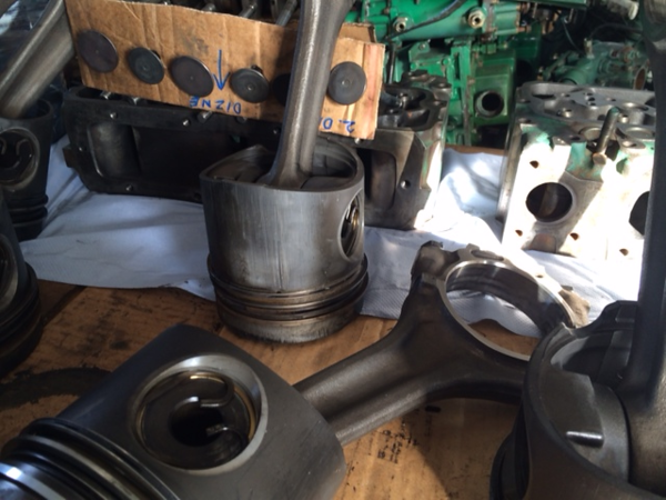

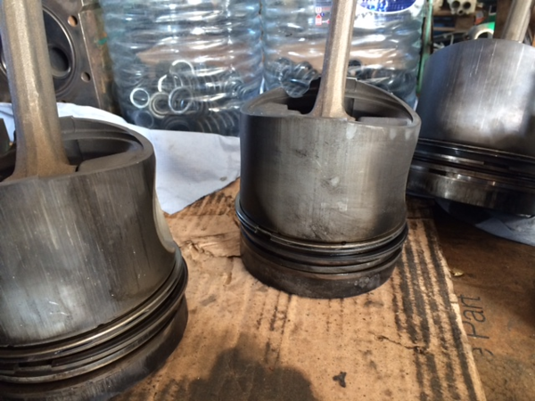

The pistons, have soft scratches, need to be replaced anyway, when the liners are new.

Some of the bearings
Pistons with damaged rods
More pistons
The liners, on the darker, non-shiny surface, one can see the original “thin groove” pattern
All gone in the polished shiny part
