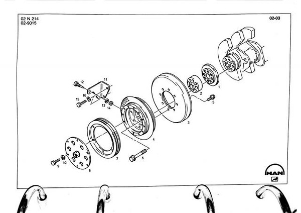

On the drawing below you can see the plate part nr 3 called “vibration damper”,
This plate consists of several layers of steel and rubber, and this is all disassembled, (due to age I guess)
But the separate rings are still there, and where slabbed around….
That was causing the very strong vibration and rattling noice.
The two pully’s with the belts (parts nr 4 and 7) are still in position, and not damaged.

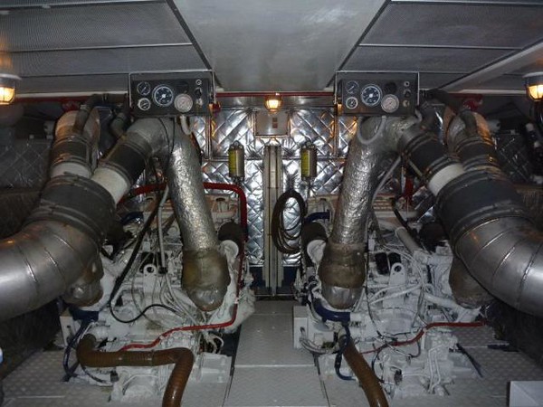

Engine room,
there is only a small gap between the engine and the bulkhead with the fuel tanks
Here is a plan of the part that broke (part nr3)

Engine room,
