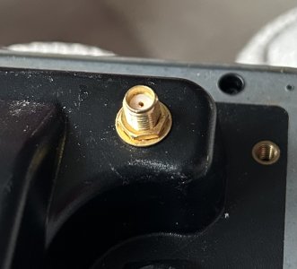

Can anyone advise what type of plug is required to connect the GPS antenna cable to a Northstar 5505 Chartplotter please?

This is a photograph of the plotter in question. Is anyone able to identify the type of plug which would fit the antenna socket please?
SMA female socket,
Zeizafa 10 Pcs SMA Male Plug Crimp RG174 RG316 LMR100 Cable RF Connector Connector Dust Cap Cover Protector Safety Plug Adapter Socket Coaxial Cable Cord Solder Bulkhead Panel O Press Electrical https://amzn.eu/d/95NGUmQ

Lots of very inexpensive GPS antennas are available with SMA connectors.
GPS antenna
At that price you can carry a spare. My plotter uses a similar one and works perfectly inside a GRP hull.
