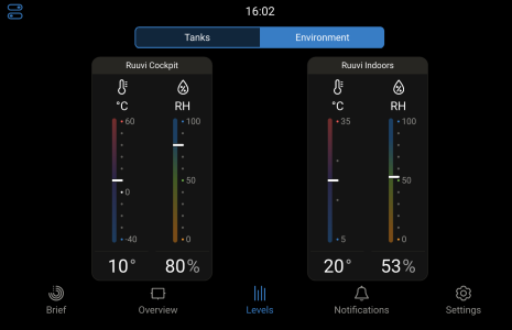

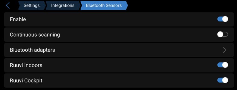

To pair the sensors, open the Victron interface and go to Settings, Integrations, Bluetooth Sensors. Here you should see your Ruuvi sensor(s), just toggle them on to pair and your Victron system will start getting temperature, Barometer, etc. immediately. At this stage, your Cerbo will display the sensor under the environment tab of the Levels page (using interface v2 here!). Your Device will also begin uploading this data to VRM for long term collection and viewing.

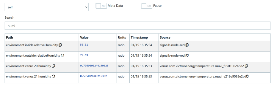

Now click on Data Browser in the left hand menu. We need to find the paths to our Ruuvi Data. In the search box type "humidity" and you'll see several values, you're looking for ones that look like "environment.venus.20.humidity".
Because I have two sensors I have two of these, each showing the ruuvi source on the right hand side. Copy the paths you need, mine are:
environment.venus.20.temperature
environment.venus.20.pressure
environment.venus.21.humidity
environment.venus.21.temperature
environment.venus.21.pressure
Yours may be different as they are assigned by the system, but they will be similar and you'll have three per sensor.

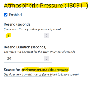

Next, click Server, Plugin Config on the left side menu. You'll see various plugins here, scroll and enable "Signal K to NMEA 2000". Don't enable any logging as it just uses space on the disk and will eventually fill it up.
Scroll down slowly. We need to enable multiple PGNs for the NMEA2000 to ensure broad plotter support since there are many versions of these and not all plotters/instruments support all of them. The list I enabled for one internal and one external sensor is:
Atmospheric Pressure (130311)
Outside Humidity (PGN130313)
Inside Humidity (PGN130313)
Atmospheric Pressure (130314)
Outside Temperature (130312)
Outside Temperature (130316)
Inside Temperature (130312)
Inside Temperature (130316)
For each one, tick Enabled.
Each will have a box at the top for Resend - set this to 1 second for all.
Each will have a box at the bottom for Source such as "Source for environment.outside.pressure". It's the "environment.outside.pressure" part we need to fill with data later, so make a note of these as they are different for inside and outside and you may use different ones than I did.
When you reach the bottom, click Submit to save your changes. We now have the NMEA plugin configured but need to connect data to it.

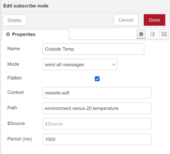

We will need one line per data point, so three per sensor (temp, humidity, baro pressure). For each, drag a subscribe and send pathvalue onto your flow workspace. Drag the grey square on the right of the subscribe box to the one on the left of the send pathvalue box (just like wiring!).
Double Click the subscribe node and fill in a name such as "outside barometer sensor". Fill in the path with your ruuvi data path from above, such as "environment.venus.20.pressure".

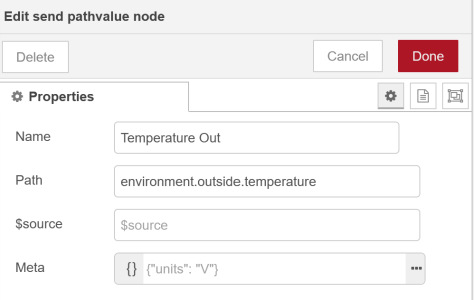

On the corresponding send pathvalue node double click and again fill in a name such as "outside barometer N2K" and set the path to the matching one from the NMEA2000 plugin from above such as "environment.outside.pressure".

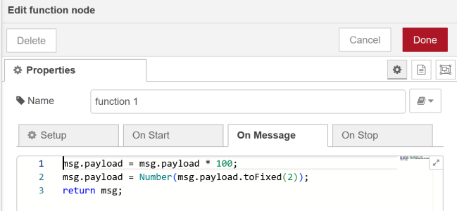

For the Humidity line, I added a function between the subscribe and send pathvalue nodes. In the OnMessage tab of this, I added the following code. There are neater ways to do this (but they aren't more efficient) but I wanted it easy to understand to share here. Line 1 multiplies the incoming value by 100. Line two takes that value and rounds it to two decimal places. Line two also tells the system to return the value as a number rather than text. Line three sends the result to the next node (send pathvalue).
"msg.payload = msg.payload * 100;
msg.payload = Number(msg.payload.toFixed(2));
return msg;"

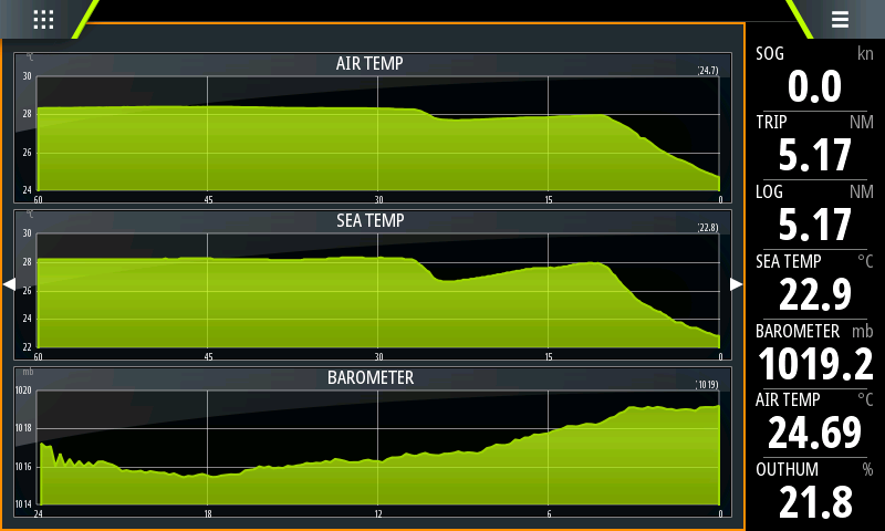

This is what it looks like on B&G Vulcan:
I think there are a couple of size options - when I tested it I had it about 1" long alongside some numerical displays for boat speed, depth etc.​
As I say, I got this feature "for free" with my masthead wind transducer - I wouldn't pay £130 for it. You can get Arduino type boards and electronic barometers so cheaply on AliExpress that I bet someone who's handy could implement an NMEA 2000 barometer for £10 or £15. I assume Yacht Devices have to pay licensing fees to the NMEA certification organisation.

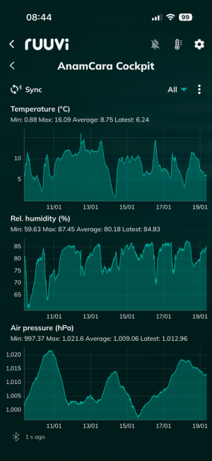

Same reason I put one Ruuvi in the cockpit and one in the cabin! Now I can see how cold and wet it is outside and how warm and moist inside 🤣
On signalk you can also subscribe to a MQTT service and use small esp32 boards with a £4 barometer, hydrometer and thermometer chip to send the data to the raspberry pi. Not as simple as a single device and requires local power.
Yes I did consider that. My Pi stuff is in storage so I kept putting it off and having the Cerbo ultimately made this easier but it would be useful if someone could write up the specifics of that solution.
As a result of this thread I have been looking into how to get a pressure trend on my iPad from Seatalk NG, and it might not be that difficult. The data from the YDBC-05 pressure transducer can be sent to an NMEA2000 wireless transmitter and then picked up by the iPad using an NMEA App (there are a few).
I realise you have the sensor already but the Ruuvi app is so good it might be worth just getting one of those. I assume the app is ipad compatible, I only have an iphone. Also useful as it keeps 10 days data in the sensor so the graph is there when you arrive.
