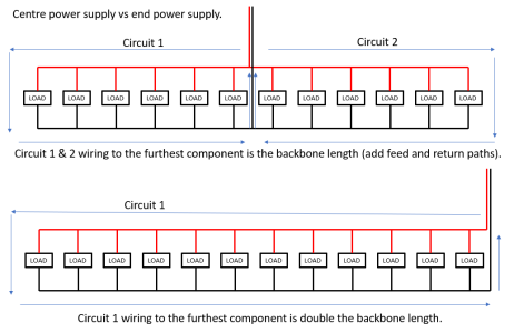

Using a substantial backbone cable for your NMEA network is good advice. The connected instruments are important for safety. However, superior backbone cables are expensive.
Duplex tinned ordinary power cable is cheaper, so it makes sense to supply power to the NMEA backbone where the voltage drop at the ends will be similar. Of course, you can do both, belt and braces.
