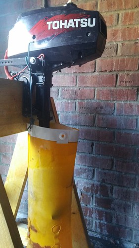

When cruising, there's no realistic way of flushing an outboard with fresh water.
I guess it depends how big the engine is, and how restrictive your fresh tank...but if you're using a dinghy, most likely you can reach a source of fresh, ashore. I found a punctured buoyancy tank in a scrapped sailing dinghy in the weeds at our club...
...I cut the top off it, put cringles in to reinforce the PVC, so it can bear the weight of 15 litres of water, hanging around the tiller. It's a tight fit round the prop, but not a problem in neutral. I've never had to leave the engine with seawater in its system.
