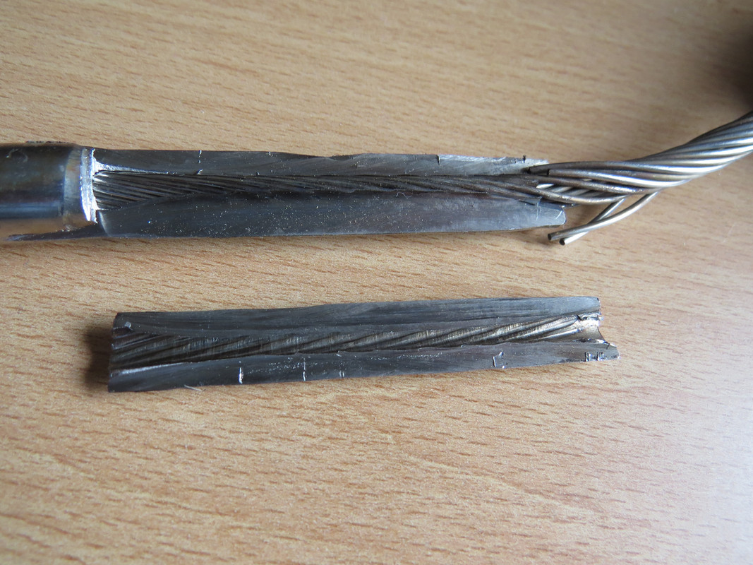

If the swage has been made up correctly its metal extrudes into the lay of the wire. Although I have seen corrosion at the open end of the swage I have yet to see it well down inside. This photo does not show this particularly well because the wires sprung open when I cut half of the swage off but they are extremely well compressed as made.

Thanks Vyv, that's very informative!
