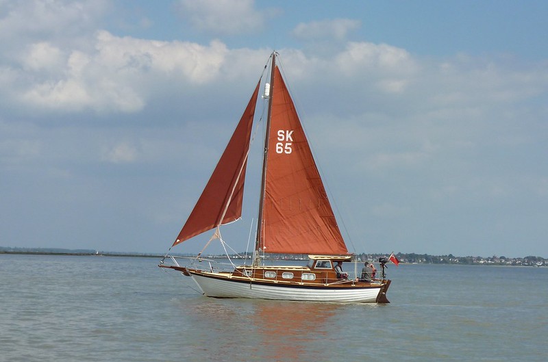

Nice to see another Sea King at sea as well.
