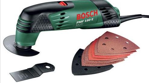

I suspect that under the 'thin GRP was a ply floor which if you cut out the GRP, will resemble compost in the bilge! Common construction in the type of vessel is to layout the 'frame' of stringers and ribs, encapsulate in GRP and then affix a ply floor on top followed by another layer of GRP. I'm rebuilding a similarly constructed boat, but I'm encapsulating the ply floor with GRP first so that it cannot rot from beneath if the 'cells' of the floor are compromised. I used one of those multi-tool vibrating saws to cut out the old GRP and it worked very well!
e.g.:
