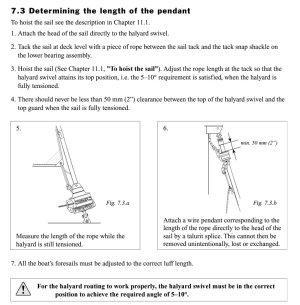

First thing I would do ? On a quiet day - hoist the jib ... step back far enough that a photo can be taken of the top section of the hoist ... showing angle of halyard / length of foil above sail head / distance to mast head etc. - similar to the photo I put of my setup.
My 38ft'r ... Alex and I had trouble on her with halyard wrap ... binoculars and viewing from various angles soon had us finding the solution ... a short length of strop to raise the sail head ... the increase the halyard to stay angle. We added the strop at the tack so we could adjust till we had the length correct. That length will then be transferred to webbing strop and used at sail head to raise the furling top ..... see attached. It is for my Furlex system - but it applies to all systems of similar setup ... such as the 406.

The halyard and furling line are one continuous length so you have a very long line. It is important to tension the halyard well before wrapping the furling part.
