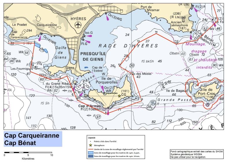

Thanks - years since I've been in that marina.
Doubt I'll ever go to Porqs ever again bcz they have totally banned >24m boats inside the red line below. Used to be a good spot to top up fuel then anchor overnight before crossing to Mallorca (Alcudia)
