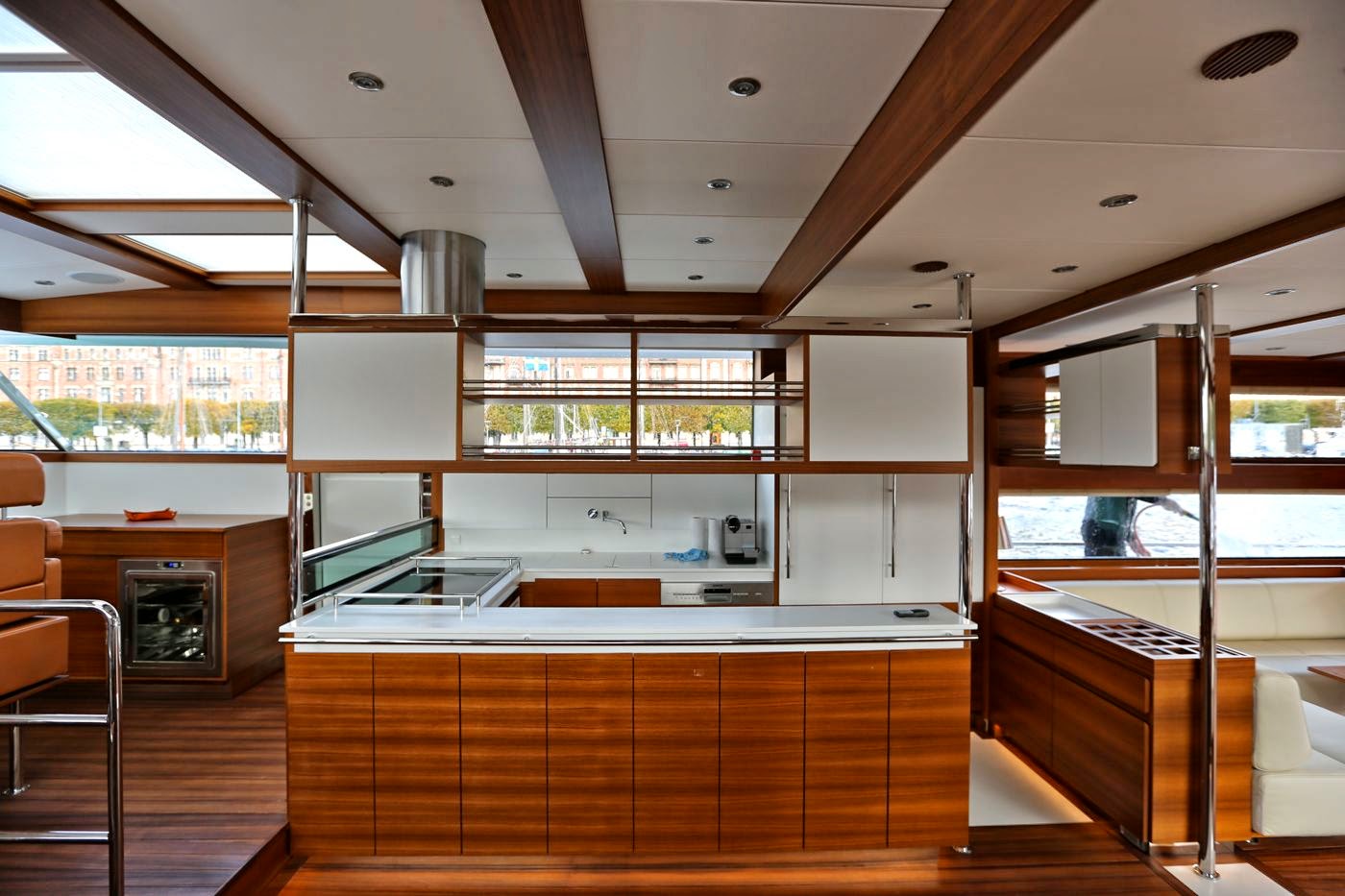

3. I'm trying to see how to fit an internal staircase from galley/somewhere aft of lower helm, to the flybridge. It's a pity the flybridge windscreen is so far back. It would have been easier if the fly windscreen was closer to the glass panels above the lower helm (like the above photoshop). At the moment, the staircase would have to land aft of the galley, which isn't great. Any ideas? It's quite a big deal to change the fly mould to put the windscreen further forward, obviously, though anything is possible...

I don't think the forward stretch would be feasible as in your "after" pic, because it looks like they went as forward as allowed by the raised p/house underneath.
On further reflection MapisM I don't think that's correct. See picture below (I did not hot-link because it is too wide). There is a big distance between the step up in the floor to the helm, and the step in the ceiling at aft end of galley. If Delta would stretch the fly windscreen forward by say 2m, the step in the ceiling would move forward 2m, but that's ok. Then the staircase could go athwartships at the aft of the galley (losing 500mm of galley length). Or in the equivalent position on the port side. The staircase would then emerge on the flybridge just aft of the helm chairs, near the outer edge (port of starboard side) of the flybridge deck.

On further reflection MapisM I don't think that's correct. See picture below...
Yup, I didn't consider the interior pics in my previous comment, you might well be right.
