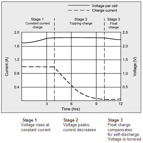

Charge efficiency is quoted as an overall charge efficiency as it changes depending on the State of Charge.
From 0-80 SoC the efficiency may be 90%, but from 80-100 SoC the efficiency will be less than 50% on average. So you only have only put in 10 Ah to the battery, the rest has been lost as heat etc...
I suspect it's even less because the current fall off will approximate a decaying exponential curve and I made a guess based on a straighter line. I think my estimate is worst case.

With most chargers they will only be charging at their rated current (Max) when the battery voltage is less than 12.5V, as the battery voltage rises the charging voltage remains the same probably 14.40V ish and the current decreases. So the last few hours will probably be at less than an Amp. The rate of charge is not linear and the last few % can take an hour or two. Something like this graph.
The rated Max charging current is probably a no load state so a completely flat battery, my old but simple chargers have ammeters and you can almost see the current drop to a steady state of 0.5-0.75 Amps for the last few hours.

I chose the 0.9A figure because it is the current equivalent to 1% of capacity at the 20hour rate (90Ah). That corresponds to 100% SOC in some multi-stage chargers and according to some battery manufacturers. After that the charger should enter the float stage and the current will fall further.
We don't know how the OP's charger works, so this is guesswork to some extent.
