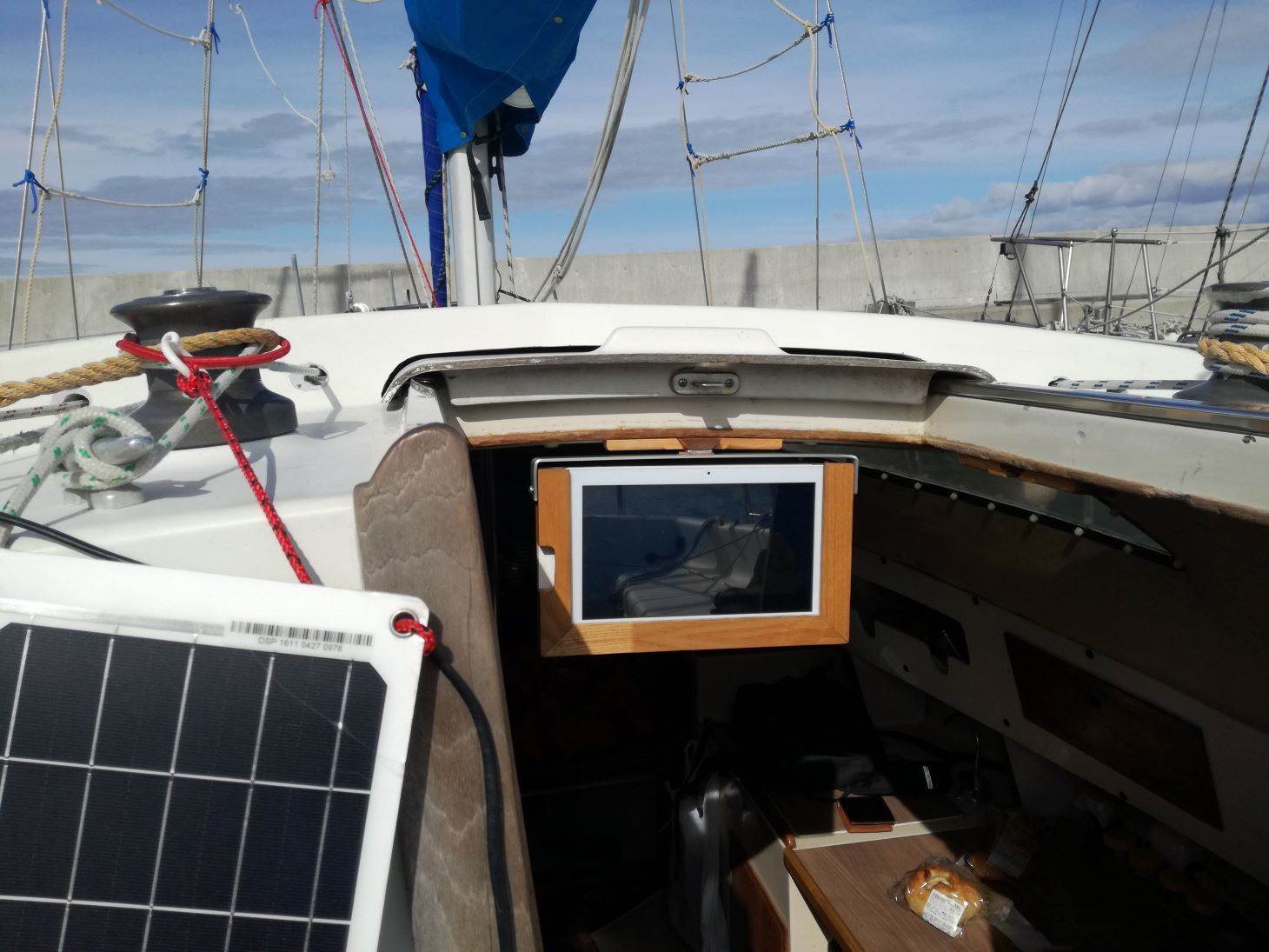

I use a tablet mounted in a frame on the table.
Takes no time to go below and check Nav app and chart.
I left the tablet on the table (without the frame) and it flew off and hit the floor.
Big distortion in one corner and a black screen.
Original mounting system.
So I bought another tablet and loaded up the charts.
After 6 months tried the old broken tablet again, just for fun and it started. Now I have two tablets.

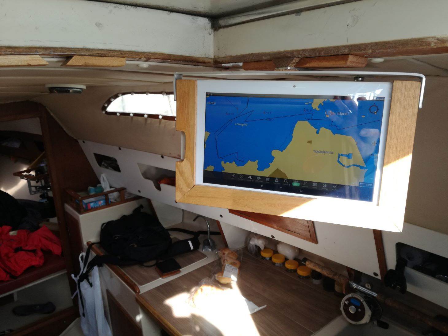

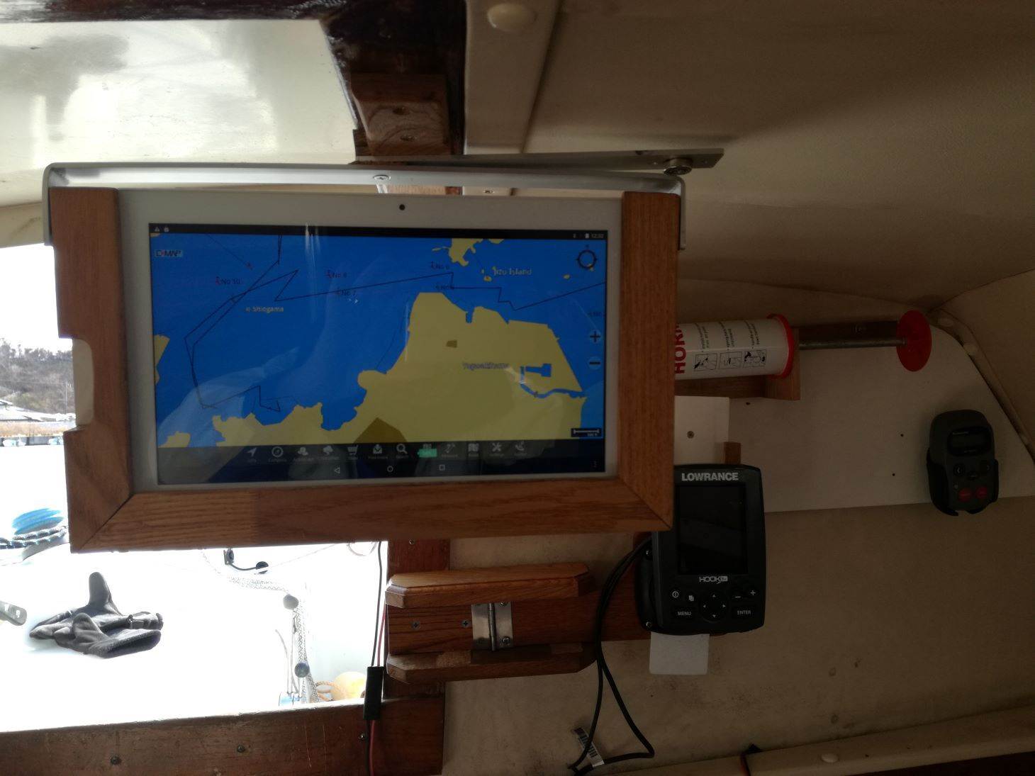

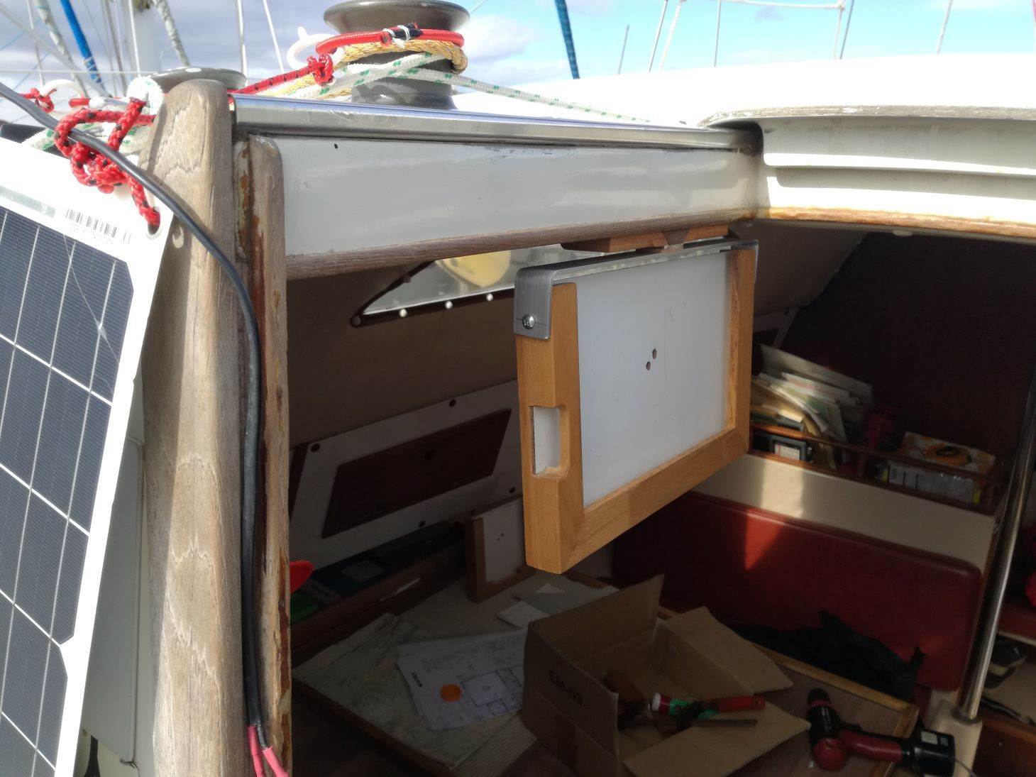

I can't use a normal swing out holder in the companionway, because I already have a swing out on the portside for the sounder and speed log.
So, I came up with a system where I can mount the Tablet on the (inner) port, centre and starboard sides of the companionway.

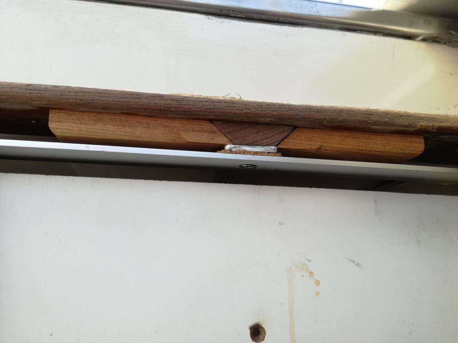

The frame has a "male" tapered cleat and the companionway has 3 "female" cleat receivers.
There is a piece of cork as a damper.
Here is the frame mounted on the port side. It can rotate to face any way,
Starboard with hatch closed
Port facing inside
Port folded up position
Center with hatch open
Of course in the sunlight you can't see a thing

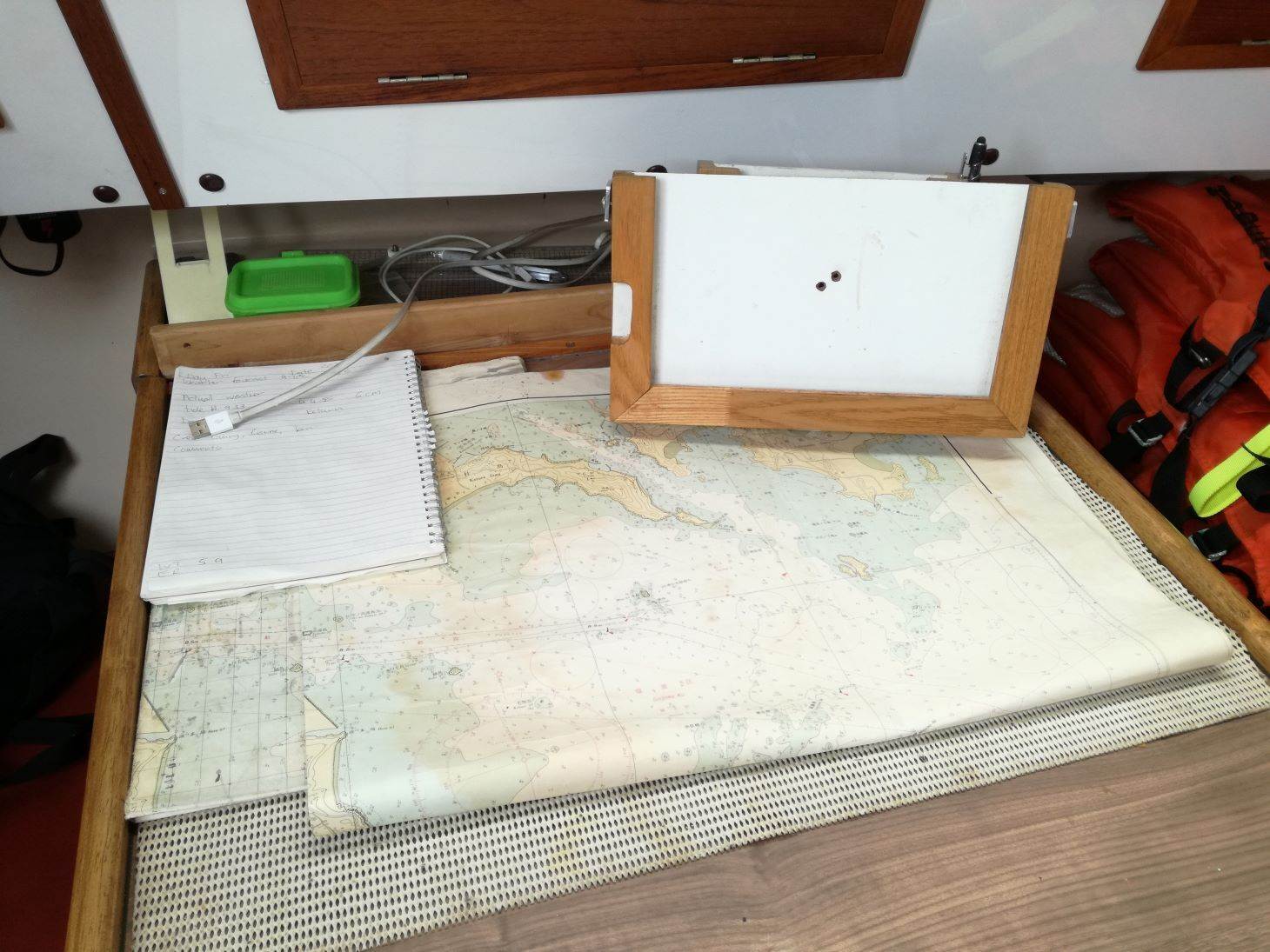

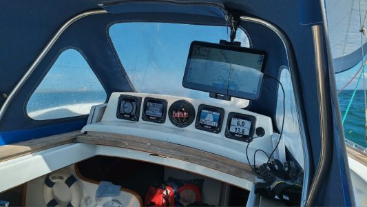

I had something similar made out of acrylic and bent to give a wide footing and hold the tablet secure. That managed to get airborne in some hairy conditions, breaking the acrylic frame but not the tablet. So the winter job was to make a new frame from old teak with some eyes to secure it if necessary. It lives under the sprayhood when sailing and doesn't normally need securing in place.
I then decided to get a new, larger tablet for inside and am making a similar wood frame to protect it. It will live at the inside helm and can be secured for the next hairy tide race. Slots to allow access to buttons and charging.
It's useful to able to check without going below, even if you have to move in the cockpit.
On mine the outside helm is under the sprayhood (and the tablet is waterproof). The inside helm already has a plotter but I want to see UKHO charts alongside the plotter/Navionics/paper info. I set the display timeout to 30 mins so repeated touching the screen is not needed.
