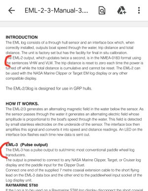

The manual is here at NASA..
https://www.nasamarine.com/wp-content/uploads/2023/02/EML-2-3-Manual.pdf
Looks like the first outputs in nmea0183 and the other as pulses which I fed into an NMEA convertor (optional from NASA with the EML). Your choice will depend on your display input requirements.

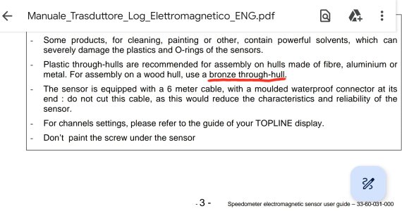

NKE do one... but I'm racking my brains trying to recall which suggested (in their fitting instructions) that use within a bronze through hull was fine.

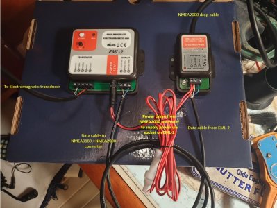

In the meantime, if you do buy the EML-2 (so that you can connect to a NASA NMEA2000 convertor), then one thing you can do to save having to run the extra power supply lead for the EML-2 box is to power it with12v direct from the NMEA converter as below...
Then for even cleaner solution, you can even dispose of the plug in power connector and just wire that power cable direct to the -ve and red screw terminals on the EML-2 box.
Although the instruction sheet suggested you could power an instrument 'from' the red screw terminal, NASA did confirm it"s fine for power in via the screw terminals (since they're directly connected to the power socket).

The bronze in wood hulls recommendation is because there is a possibility that expansion and contraction of wood can damage the normal plastic through hulls used for transducers.
I understand that part about bronze being the only recommended solution for wooden hulls.
What I don't understand is why the statement didn't include bronze actually being a better (or even a possible) solution in GRP.
Because you really don't need the properties of bronze in hulls made of stable materials. The normal plastic is fine - no benefit from bronze, nor any downside if that is what you have.
