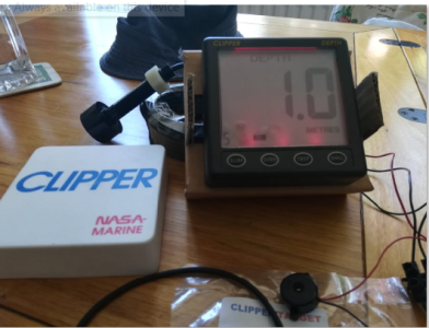

When I connect it up to a 12v battery it all appears to work, and I can hear the transducer making a rapid ticking noise.
With the transducer in air it indicates a depth of '1.0 metres'.

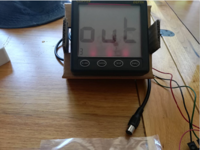

With the transducer disconnected it indicates 'OUT'

Speed of sound in air is about 340m/s and in water 1500m/s.
If you point the transducer at a smooth hard wall or metal plate exactly at right angles you will get a reflection. It will read about 5 times higher than the actual distance.
I would hope that it read 'out' when the transducer was out of the water.
I have a bilge keel boat on a drying mooring, that's what my Nasa sounder says at low tide.
I think the transducer is poorly matched to air, so you get a very strong signal returned at zero time when the thing is out of the water.
If you set a keel offset, then you can get it to read various things in shallow water.

Indeed RTFM
'However, if the transducer has not been connected, or no echoes are received for any other reason, the word
DEPTH is not displayed and the unit waits for another five seconds before showing “out”'
You will not get a good reflection from mud in air which is why I said use a hard flat wall or metal plate. I have done this test numerous times with different echo sounders and it always works. There is no zero time reflection but you will not get much range - probably only a few metres.
The only echo sounder i have owned that worked indoors was a Lowrance Eagle paper sounder, that would show the walls indoors! if you put a transducer in a bowl of water and put your hand underneath it and can feel it ticking and pulsing, you can safely assume it is working.
