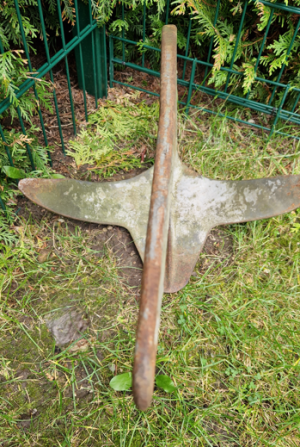

Here's the anchor I removed from my last boat when I bought it in 2011 - It's been a garden ornament for 13 years - guess where the hole is ...
