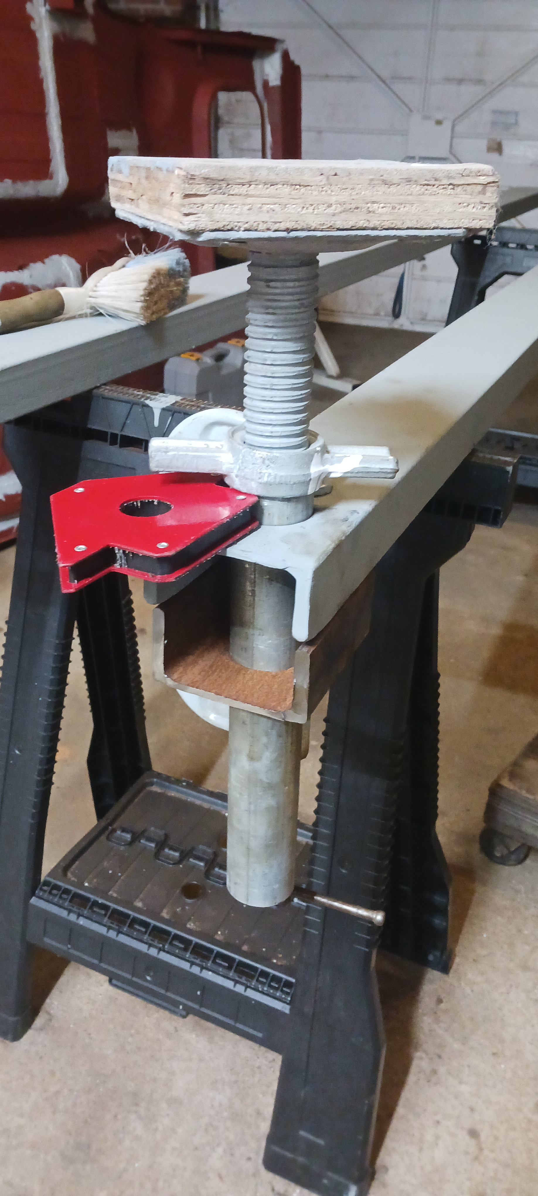

One thing I have to resolve is that the trailer is all wrong for the boat. I've devised a solution. Nearly ready to stick it together with an arc welder.

One of my goals for January is sorting out new trailer supports.
I had to finish the install of 40amps in the garage, then fit a 16amp commando socket on a new B16 breaker.

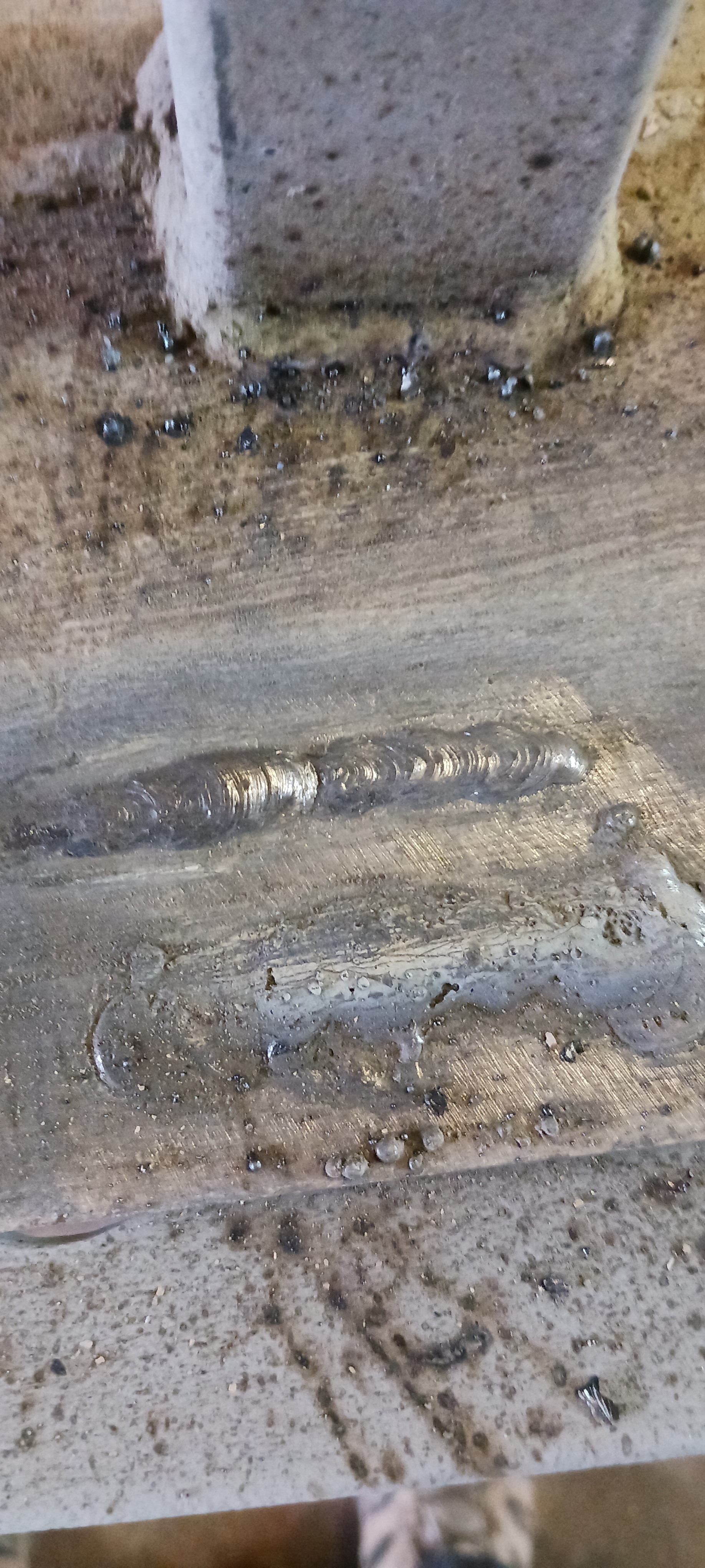

Bought myself and unfeasibly cheap Sealey stick welder and a pack of 3.2mm rods.
Had a go, seems ok.
I've cut all the steel and drilled the holes, I'll stick it together this week and photo it.
Its a masterpiece of fabrication.

The steelwork for the trailer is all welded up and ready to be fitted.

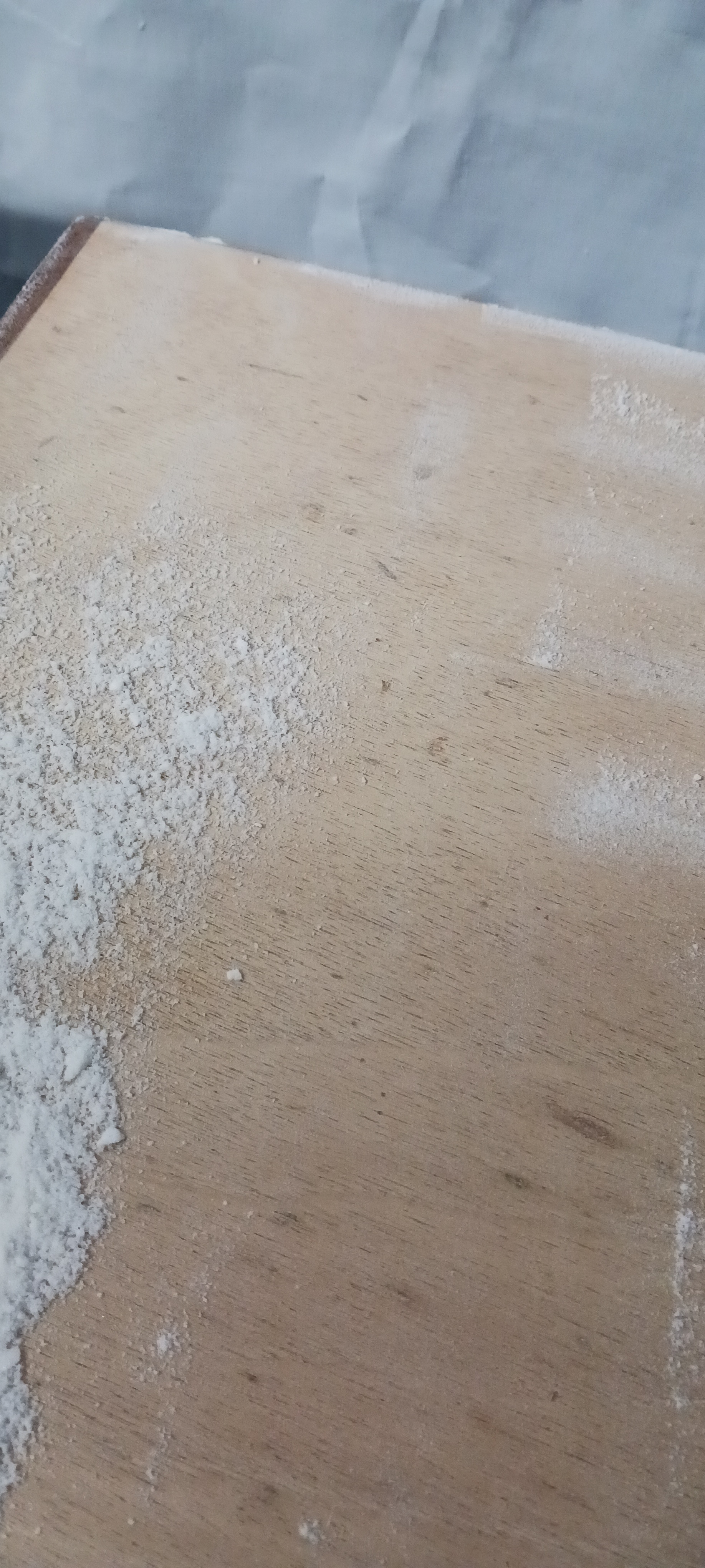

I had a go at improving some a piece of ply that was a bit stained with oxalic acid. Didnt really work. I used cold water, I think that might be an error. Its ply, so a reall hard sand is out and I really want it varnished and looking good.
Quite funny, my 1990's was quite hedonistic, I was laughing tonight the the oxalic acid looked like a load of coke.

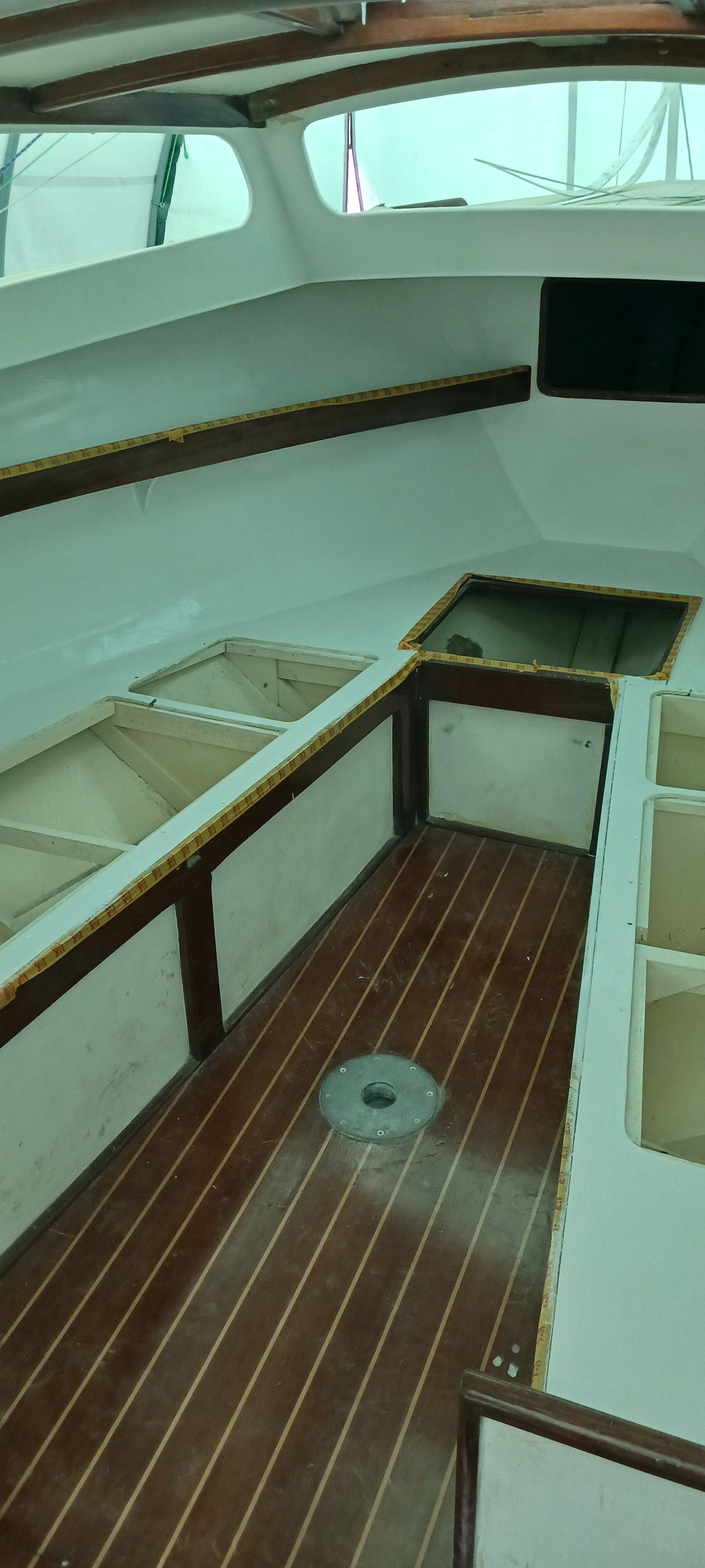

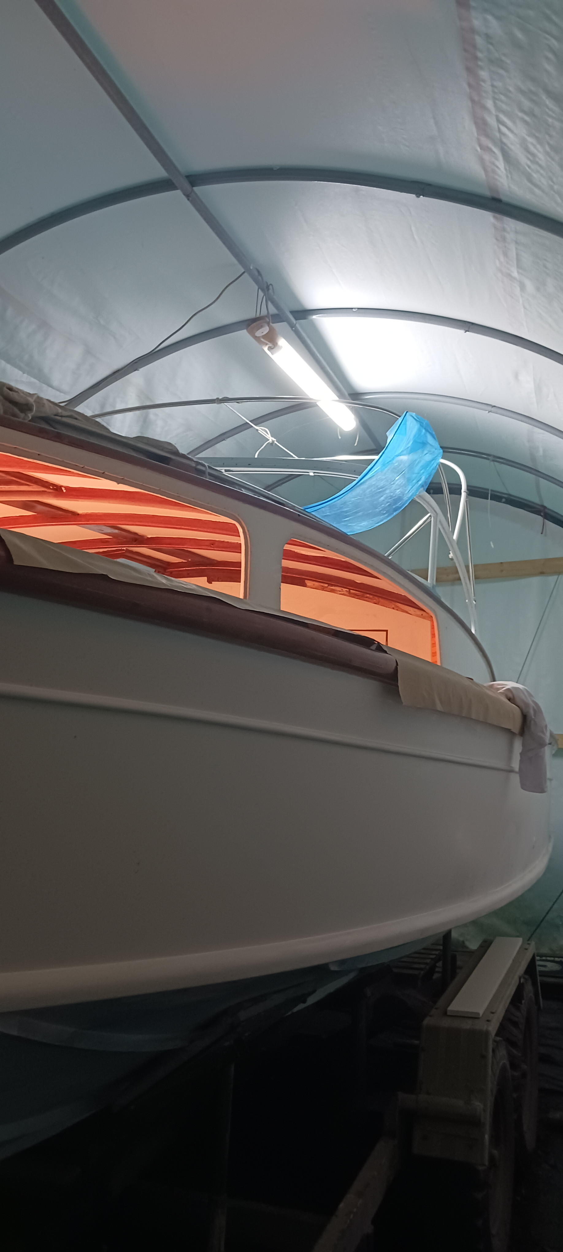

I've started undercoating in the cabin.
I love painting boats.
When painting, I try to keep progress the same in big areas, its more efficent.
I have a word, a made up word of my own making, when there's an area that's laging behind, I say 'it needs to play catchyuppy'

I had a decent result removing stain from wood with this
https://www.amazon.co.uk/Rustins-WBLESET-Wood-Bleach-Set/dp/B002HMVZW6.
IIRC, one can is oxalic acid, they other is H2O2.
Might be worth a try
Thank you. I'm going to have a go again when its warmer with the oxalic acid I've got, there's a thread on here that says temperature helps.
I've been busily undercoating in the cabin, still lots to do, I think I might make up a satin finish with 50/50 undercoat and top coat for in the cabin. Maybe. Undecided.

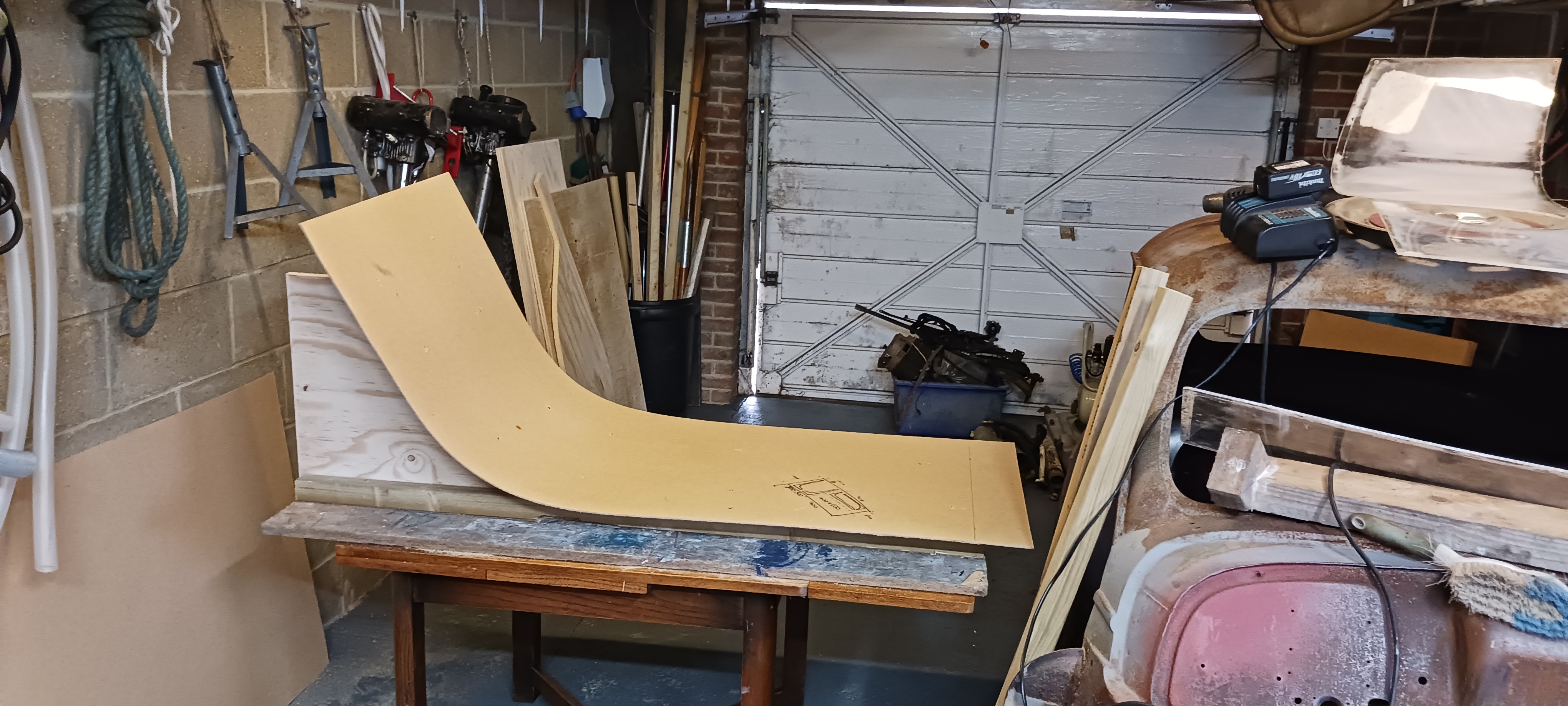

Fairey motorboat windscreens are mostly acrylic plastic with curved sections.
A company in Poole, Precision Units, are the people Fairey Owners tend to use.
I took all my windows, flat cabin windows, windscreen sides and dash are all flat, so easy.
We rummaged in their shed looking at bucks, none fitted my screens, so I have to make bucks.
We had a chat about the process and how they wanted the buck to look.
I made the first one, found the other one to be very different, so today took the old screens back to the boat.
The port screen is a very good fit...I had made a buck for the stbd screen which is a very poor fit....
So I've remade a buck for the port screen, very happy with it.
I think I can see how to make a buck for the stbd side, all the wood is cut, I'll screw it together tomorrow.

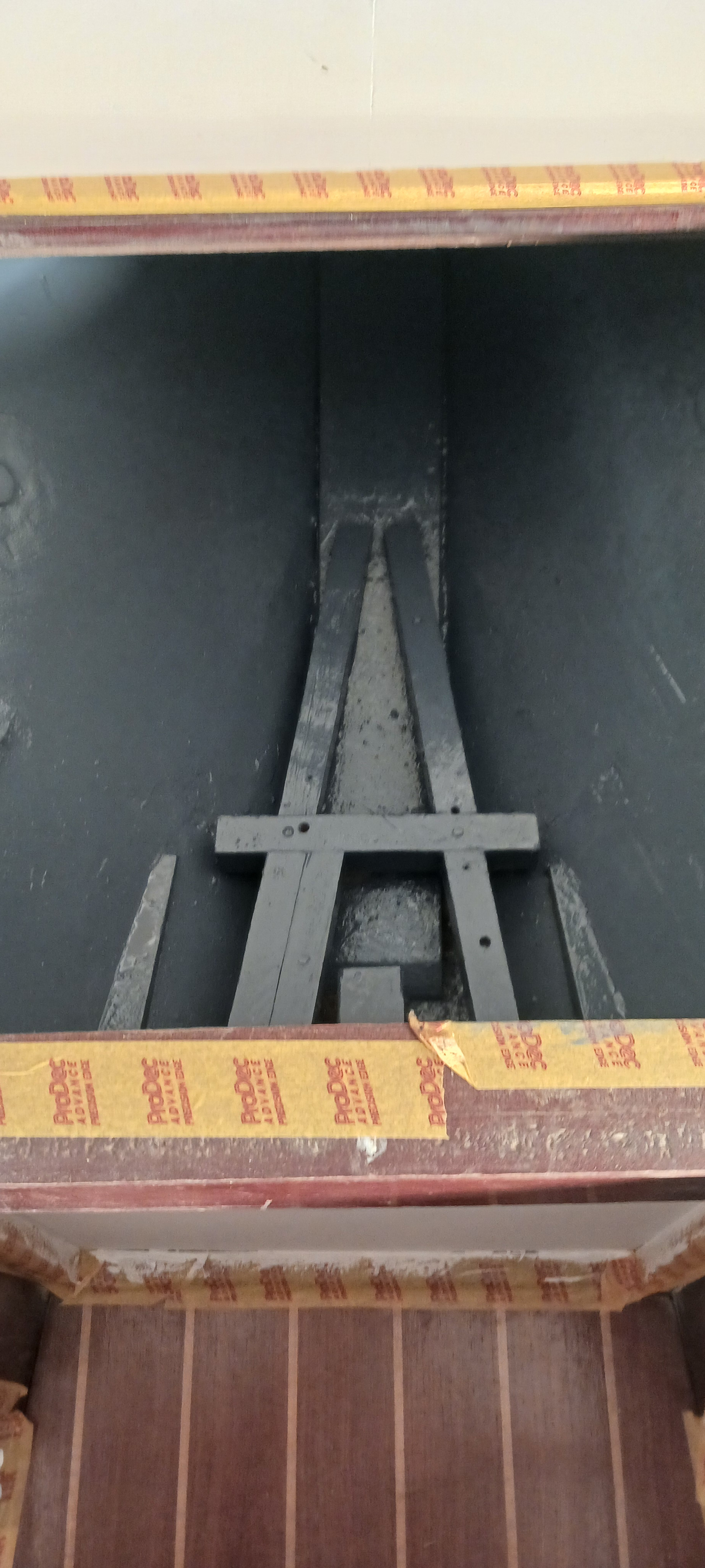

Good progress today. Lots of undercoat on in the cabin and a few locker lids prepared for paint.

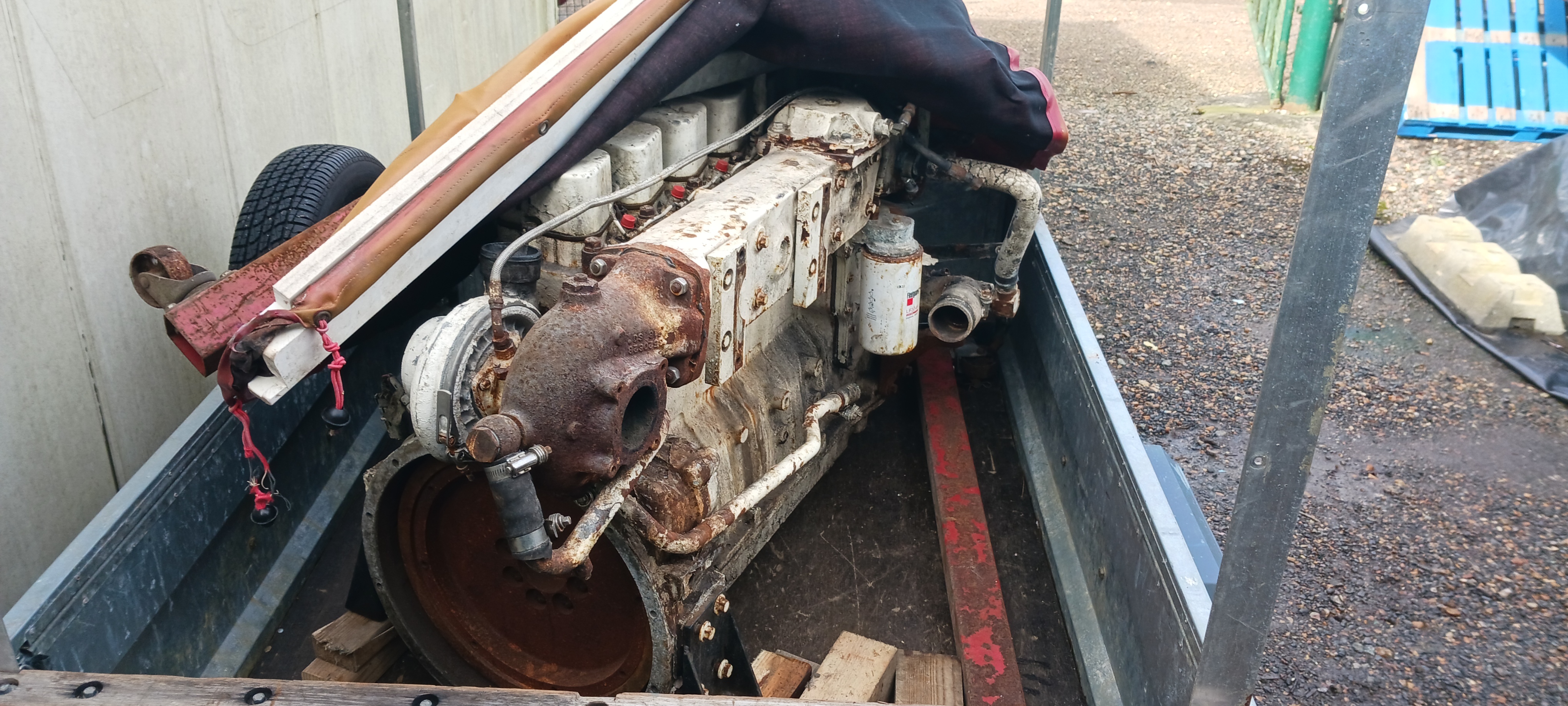

Engine loaded into trailer to come home for a spruce up.

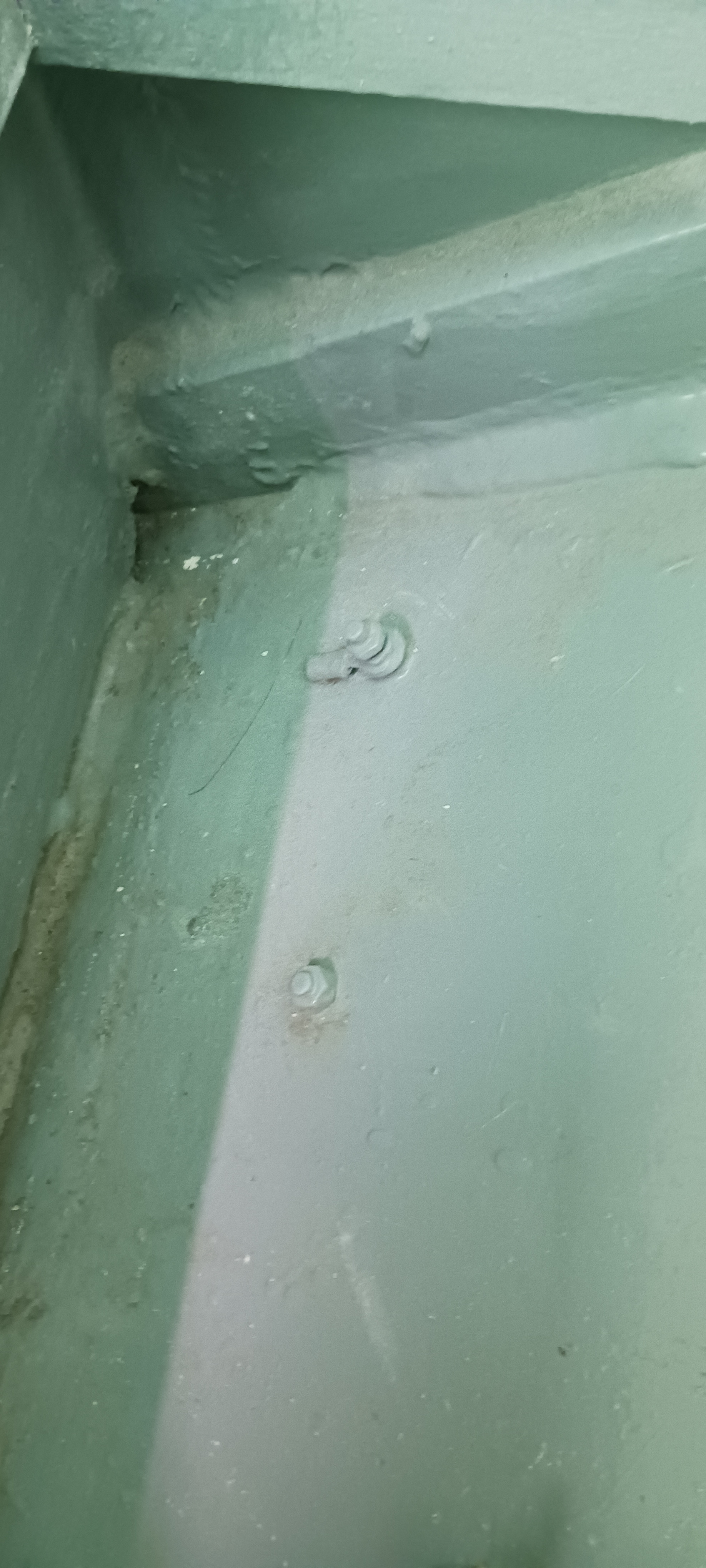

Found an orphan bolt, with a crimp terminal, covered in paint. Why would you do that? I'll knock them oot and glue plugs in.
