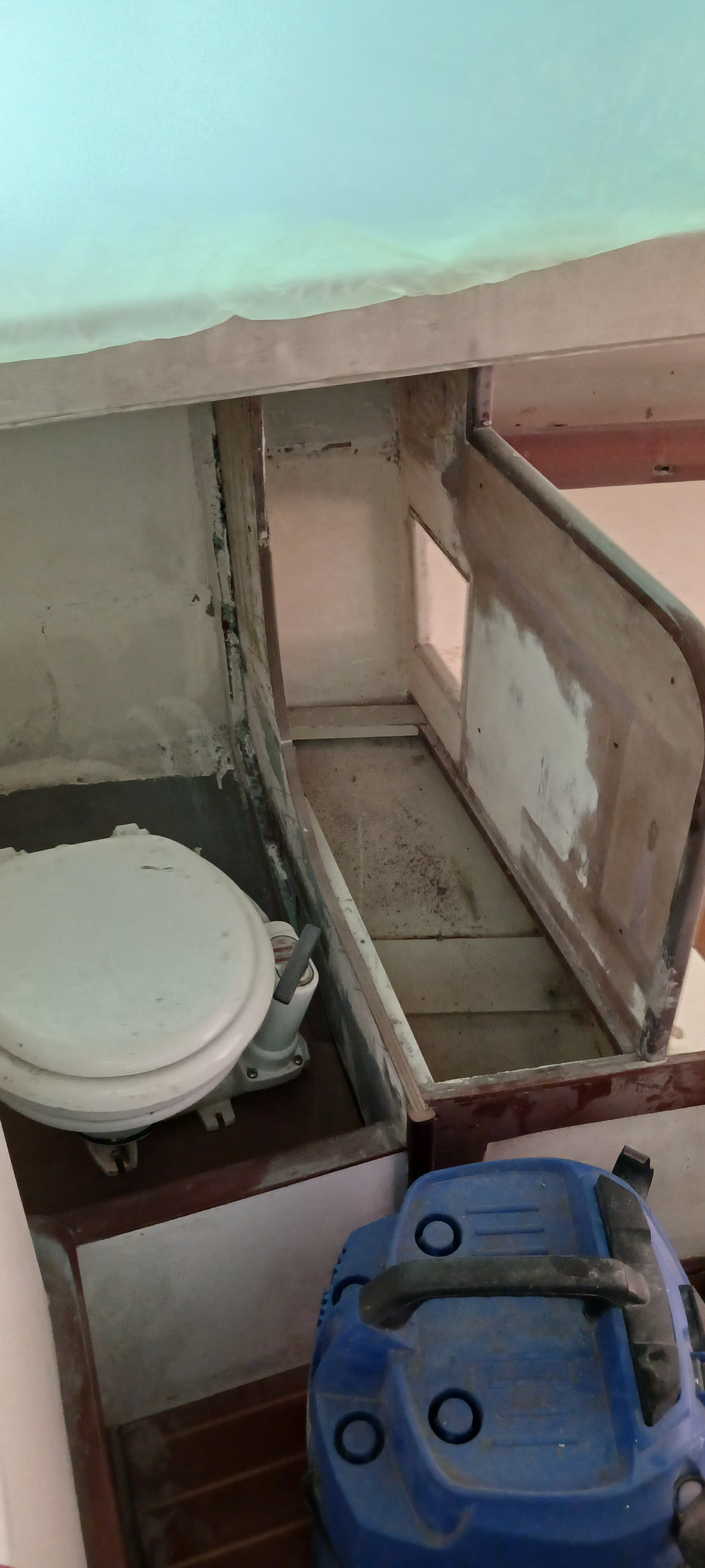

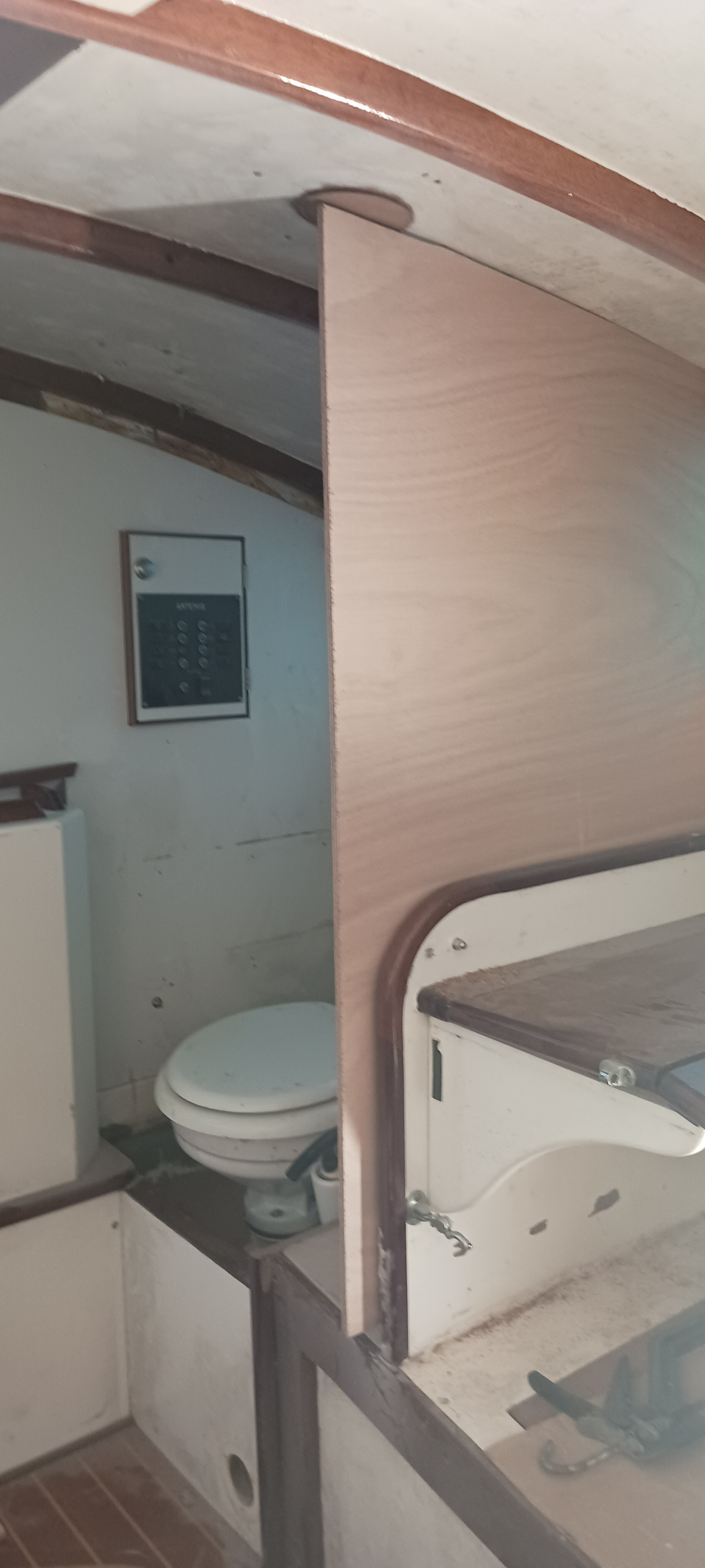

Update. I'm still crap at taking pics. I forget and when I remember they are rubbish.
I am essentially out of the woodwork. There's a few tiny bits to do, very minor.
There's a dinghy in my porta cabin, that will have to be ousted to make space for parts ready to refit.
I'm onto paint and varnish, the biggie is in the cabin. So much work in there.
They'll be a veritable production line of door and lids and floors to paint.
If I can wrap up cabin painting and trailer fixing/welding in January I'll be happy.

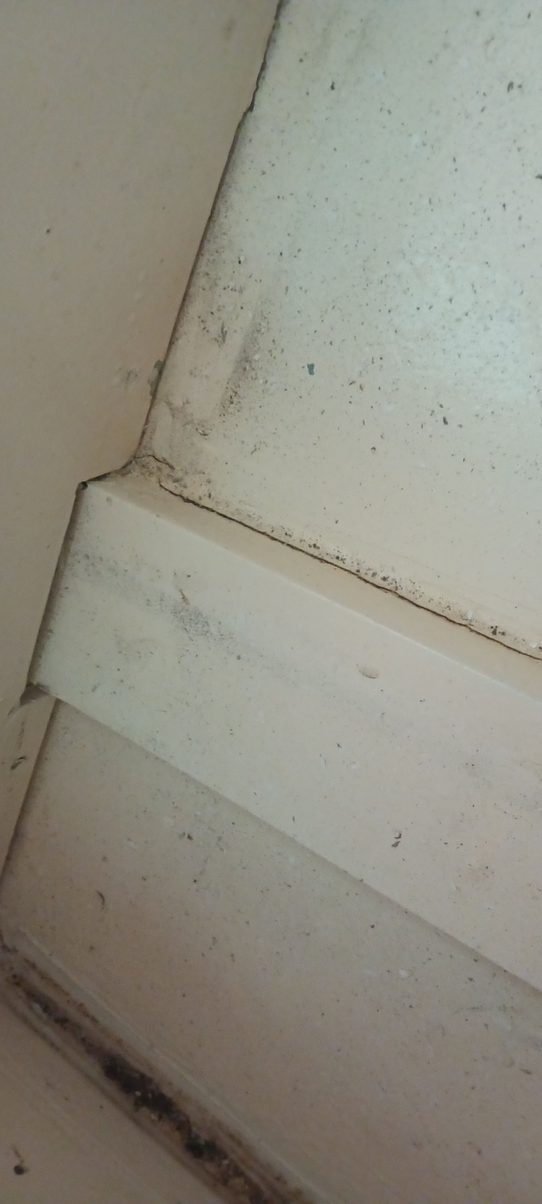

I think the remaining hours I get on the boat in January will be most paint prep in the cabin, its a right scabby mess and my wife would much prefer it to be nice!
If I can get all the sanding and dusting done, so hopefully if not too cold in Feb I can paint, that will be ok.

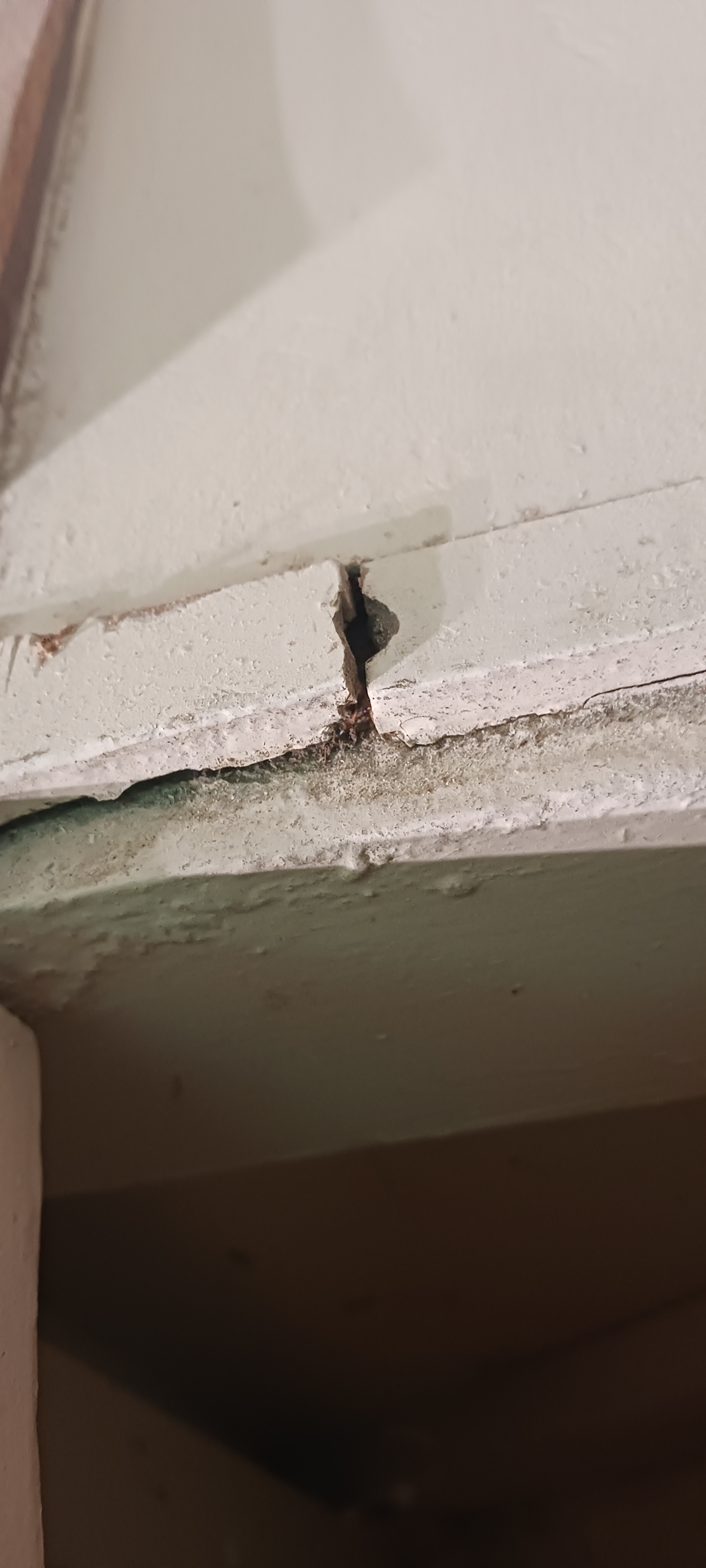

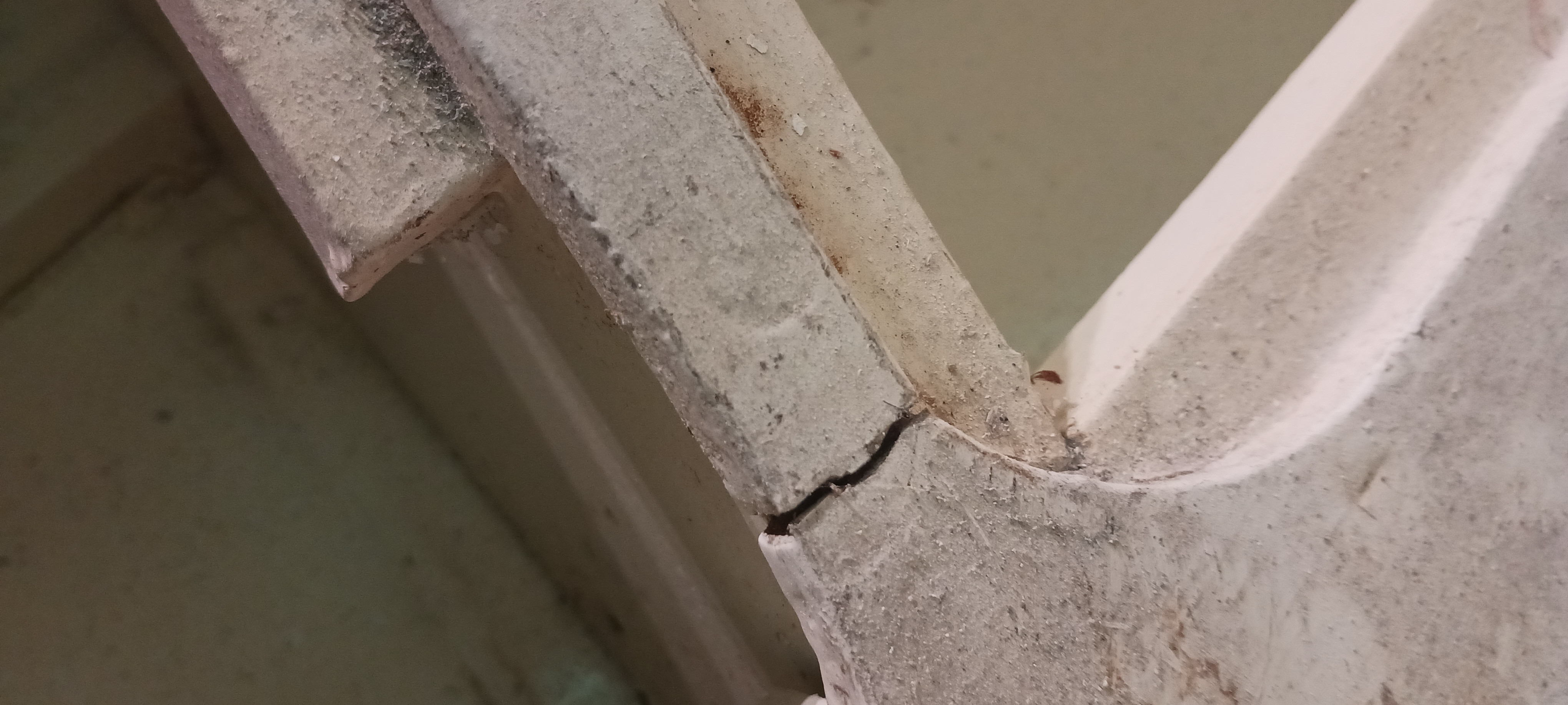

Most Huntress when built were capable of 25 to 30 knots.
In her last iteration afloat she had 315hp and did over 40 knots...
There's some damage inside, not unusual and I've sorted this kind of stuff before.

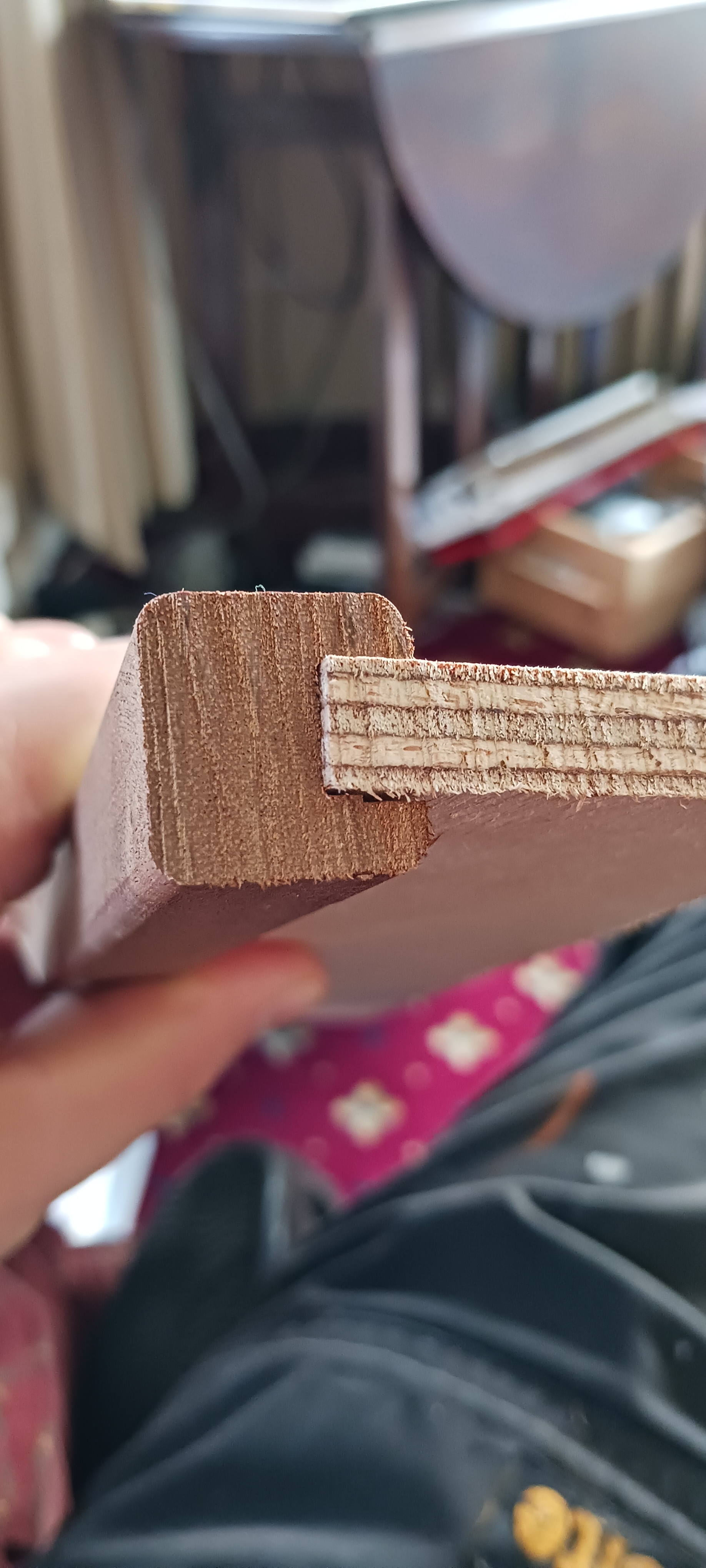

Ben, is she a wooden or fiberglass boat ? or perhaps some combination ?
All wood.
Hot moulded, a timber called agba, 2.5mm thick layers, Bordon Aerolite Glue, rubber vacuum bagged, baked in an autoclave. 6 layers on the bottom and 5 up the sides.
Scantlings are mostly mahogany, the rest is plywood.
