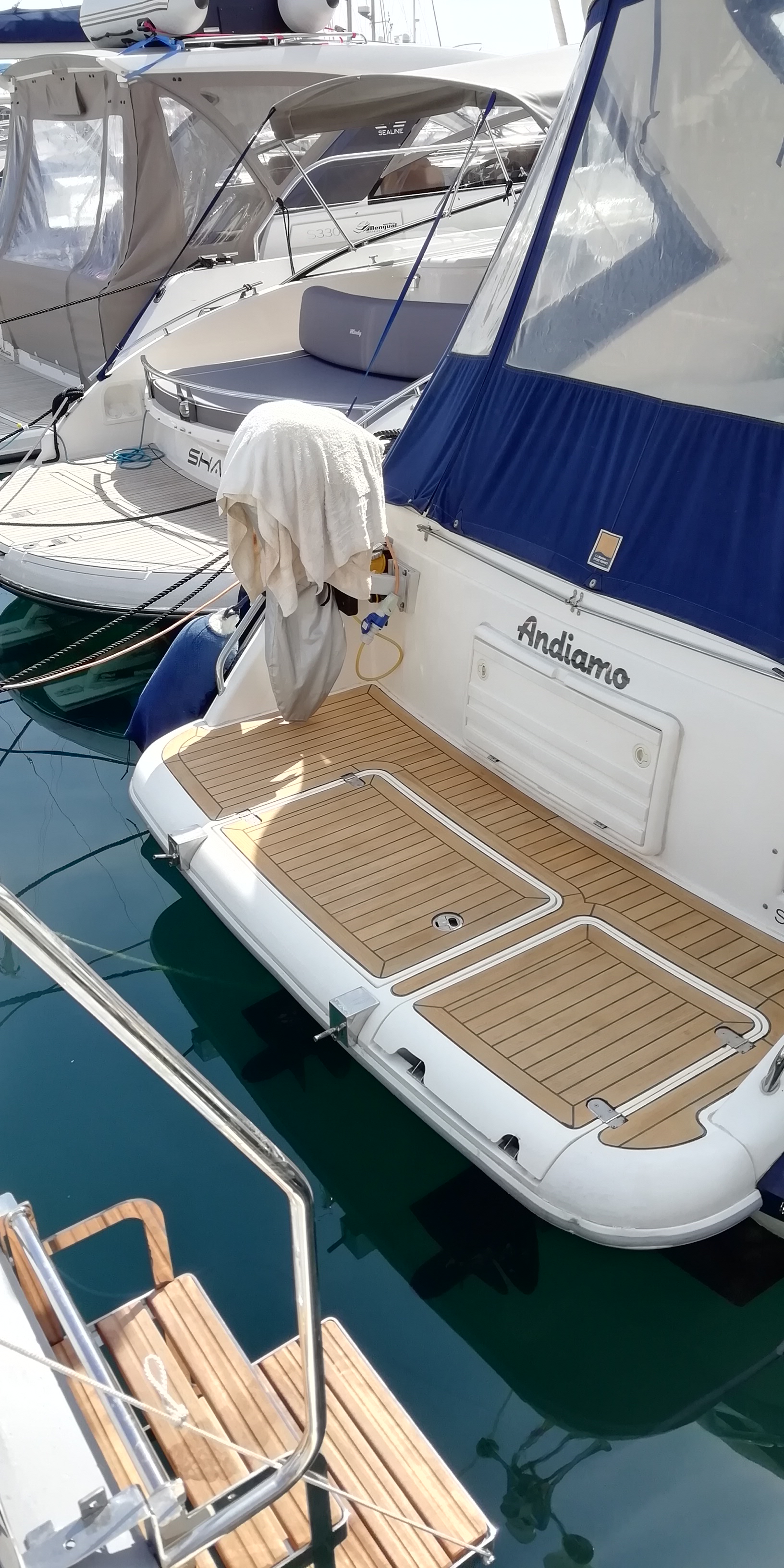

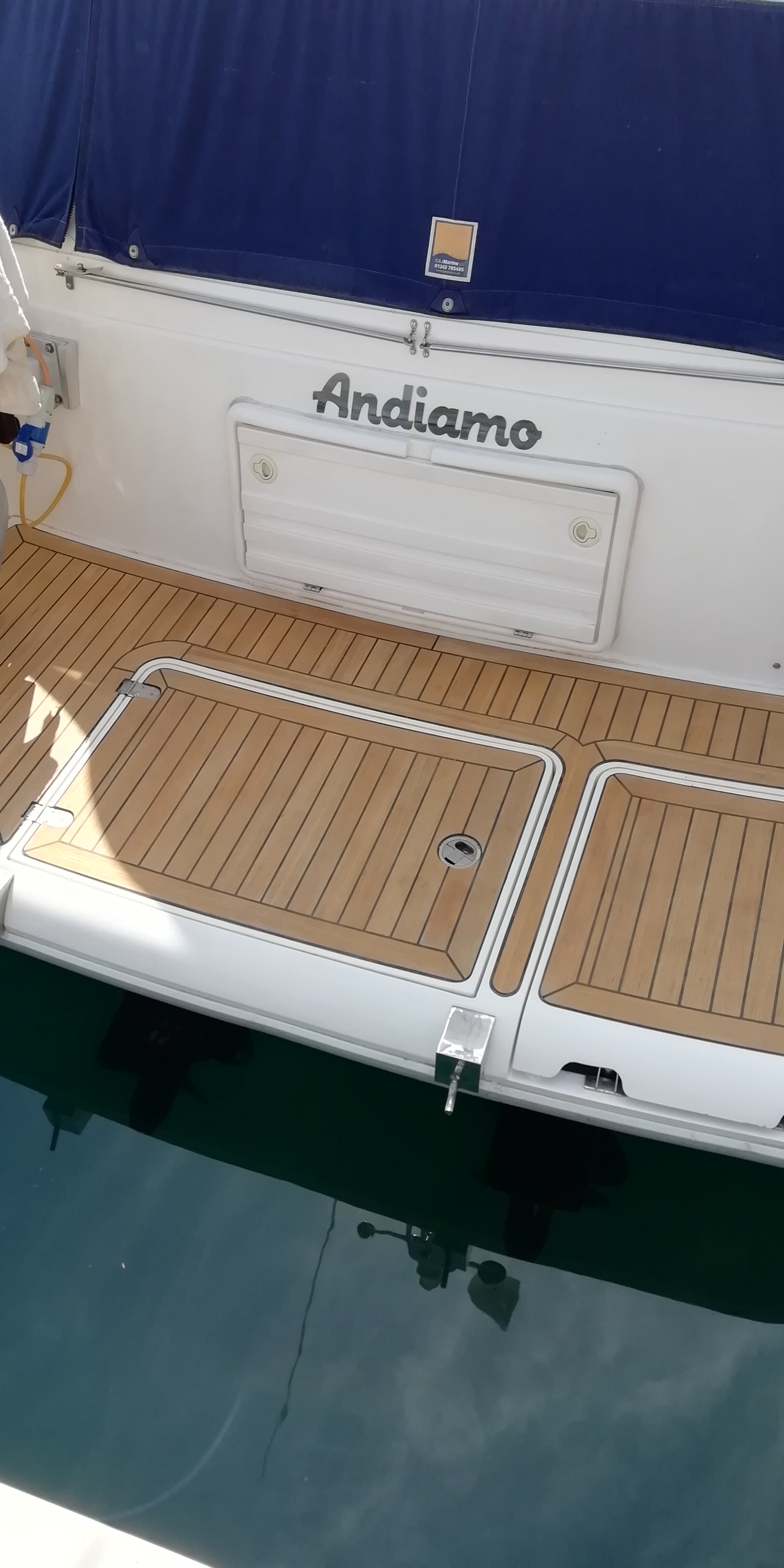

So I gave the cockpit and bathing platform a good clean using Wessex with a coat of Semco added once dry. The (18 month old) BP has come out OK, see below.
However, the black caulking in the cockpit seems to be leaching when I apply the Semco giving me grubby black stains. Is this due to the Sika (or whatever) being old, a bad batch or user error? I suspect that I will have to clean it again with 2 part or some washing powder and leave it untreated, unless Gtecniq would help.

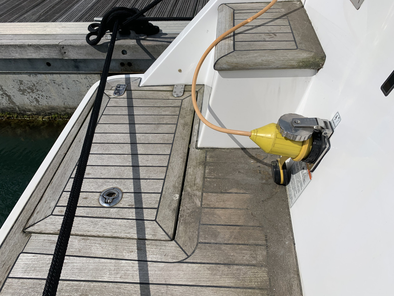

FP ended up being "parked" on a slope facing downhill over the winter.
This was not a good thing, because the water pooled on the flat surfaces and didn't run off like it usually does.
Result being my starting point this morning was this:

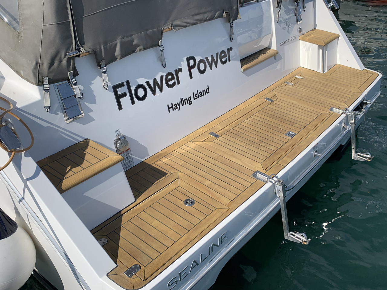

I used the Wessex 2-part cleaner, plus some Semco Natural, and now my arms have stopped working.
It's still somewhat patchy, and hopefully the colour will calm down a little over time, but it's a lot better than it was yesterday.
