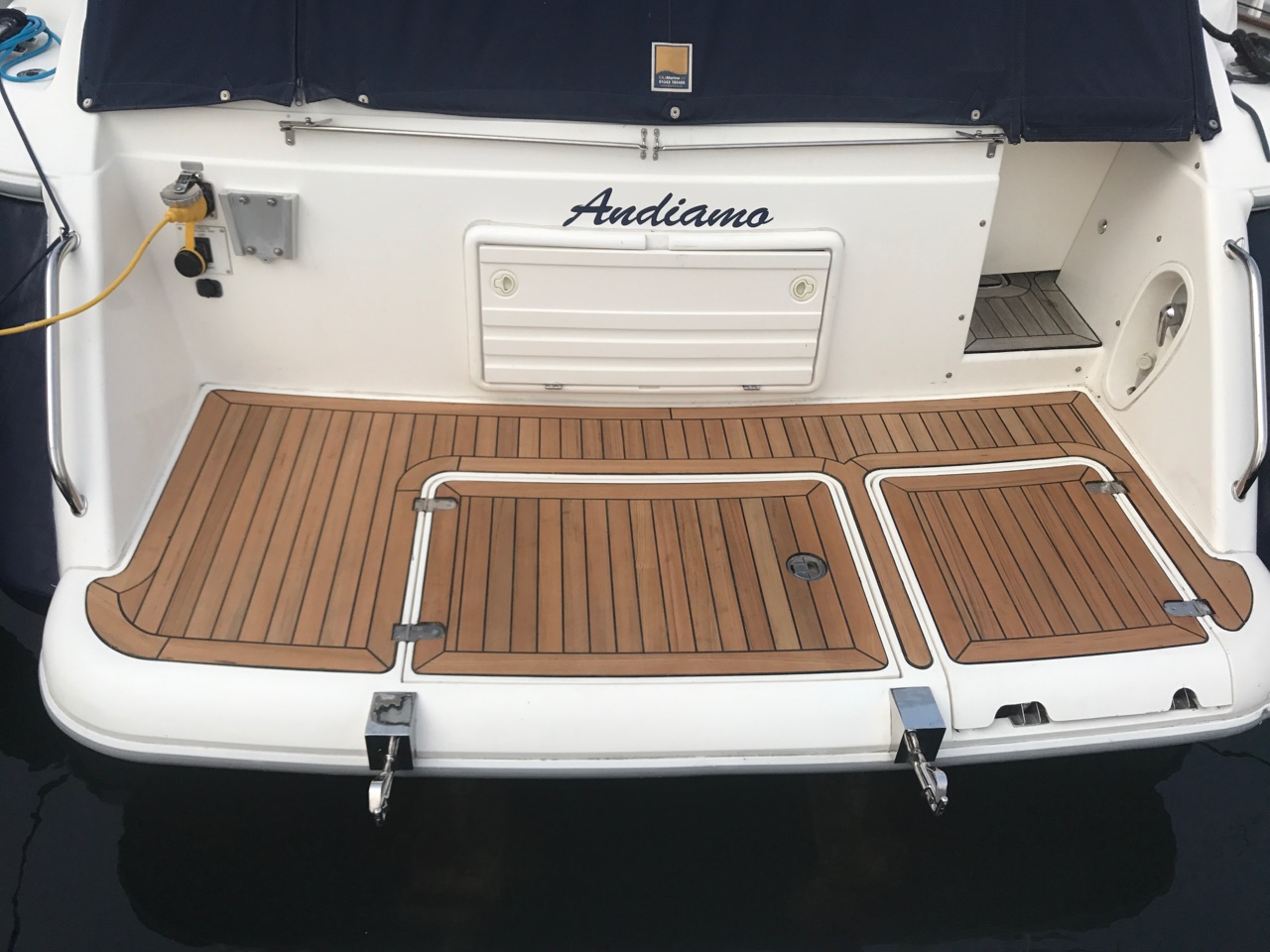

I wonder if you guys can help me. As you'll see from the photo below I now have new teak on my bathing platform however the cockpit has the original teak which is in good serviceable condition.
My plan is to give the cockpit teak a good clean (it was cleaned pre-season but has got a bit grubby with people coming and going, engine work, etc). I'm planning on using Wessex 2-part for the cockpit but I then need to pick a Semco shade to give some protection and colour consistency to the two separate areas. I do like my teak to look like it's just come out of the factory but I don't like it too stained.
