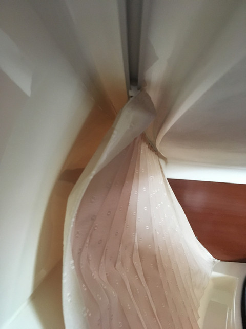

The cabin lights in my Jeanneau 805 Leader 'Smuggler's Blues' are fitted in the headlining and very much ON or OFF. There are recesses either side of the ceiling which contain the curtain tracks, and it strikes me that RGB LED strip lighting fitted into here that also had the ability to turn white and which could be dimmed would give a great deal more options for cozy evenings on board. I know that a few people have fitted this sort of lighting, and so I wondered whether I could ask some advice?

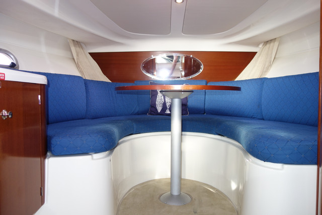

This is the cabin where I'd like the lighting to go.
My thinking is to have the controller on the bulkhead at the starboard aft end of the dinette. Then run the wire from it to the curtain recess above, that would link to the strip of lighting that would run most of the length of the recess. Then at the bow end the wire could go behind the curtain to the wooden panel with the mirror at the end, run across behind that, then behind the curtain on the port side up to the recess that would contain a matching lighting strip. So the whole thing is powered and controlled on one circuit. Is that feasible?

I fitted LED strips on my last boat at they looked great. Stick and wire up...all done
I don’t think you can go far wrong.
My only comment is if possible, stick them to the vertical surface, maybe above the curtain track if you have room so the leds are facing the hull rather than straight down. It gives a nicer effect IMHO. Mine where a bit harsh pointing straight down but then they weren’t dimmable.
You can always try in both positions with a bit of tape to hold up before sticking permanently.
You can no doubt work out the amp draw but I had 2 x 3m lengths and they pulled about 3-4amp combined according to the boat amp metre....not that it was that accurate...and old wiring feeding them etc....
I think it will look really good!
agree with FARSCO (re placement)
my only concern would be that all your surfaces around there are glossy reflective grp. Means that no matter what leds you use, you'll be able to spot exactly where each led is...
You need some decent diffusers on top of them, the leds you linked to are just plain strip.
Of course you could have the curtains to reflect/diffuse the light, so maybe it will be ok.

I would agree - place facing the curtain to defuse the light.

So it sounds like the best place is on the vertical surfaces facing toward the hull sides. Good point about the shiny GRP being reflective and diffusers sound like a good idea if they'll fit, but what is the best thing to use? (I couldn't see anything on the web site). The simple answer also might simply be to draw the curtains - they're mostly going to be used at night anyway.
Sounds like the best thing is to wire them individually from the controller to avoid them being dimmer at the end of the run. They are only going to be a metre each however, so maybe worth trying in series first (would cut down on the wiring)?

Your wiring plan is fine- the distant ones won't be dim

As others have said, you should position the led strip so that the leds are not reflected by any shiny surface, as much as you can. Will look good.
