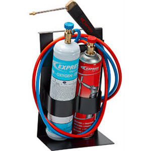

Many years ago I had a small oxy-propane kit that I used to change the wing on my Dad's car when it got dinged. A bit later, I bought a nice looking Transit to turn into a camper. Unfortunately, it turned out to be mostly filler, but the gizmo helped me batch it up, brazing everything together.
Something like this
It was cheap and cheerful, but the gas wasn't cheap, and you didn't get a lot of it.

That would probably be suitable @Stemar but a quick Google search tells me that it’s no longer cheap and cheerful (for a small job)

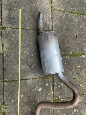

I have two of these cars, both in exceptional condition but their Achilles Heel is exhaust system. On the other car, a grey one, a few months ago I had the back box repaired by welding a huge patch in place. This was done by an MoT garage so I assume it satisfied their own requirements. The repair requirement on my black car is to the pipe so tiny in comparison to this:-

Big bore stainless steel exhausts are available but not my choice. I wish to maintain originality. I’ve tried a few custom exhaust manufacturers, all to no avail. I’ve recently found a new rear box made in Italy. One was available in Germany but the company refused to deal with me. Eventually, I found a UK company prepared to import one from Italy. It cost me more than twice the price of the one in Germany but hey, think of the benefits of you-know-what.
Car is Escort RS Turbo.

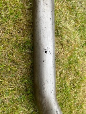

These are the two holes in question:-
Well the traditional "fix" would be exhaust paste with a tin can wrapped around, held fast with some wire. Works a treat.
Exhaust paste with header tape around it might be prettier, or just bite the bullet and get a stainless one made up - it'll be cheaper in the long run.
