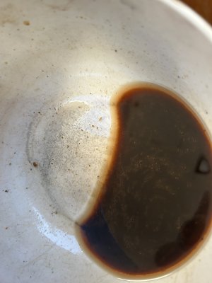

my manual only lists the main filter. Do you know the # of the pre-filter? Did pressure within the fuel tank get things purged? O
