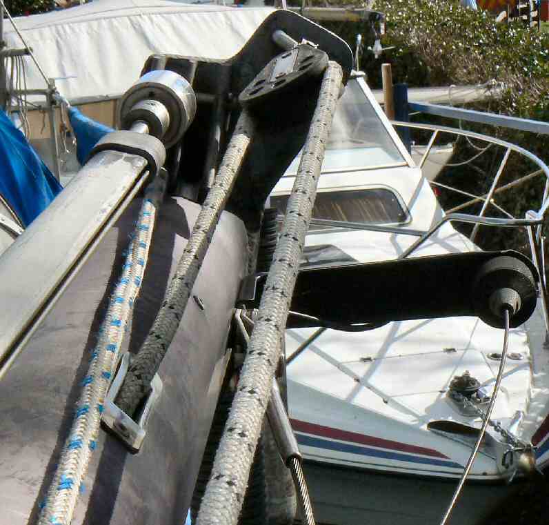

What does yours look like? this is one example to show the kite block, still quite close to forestay though.

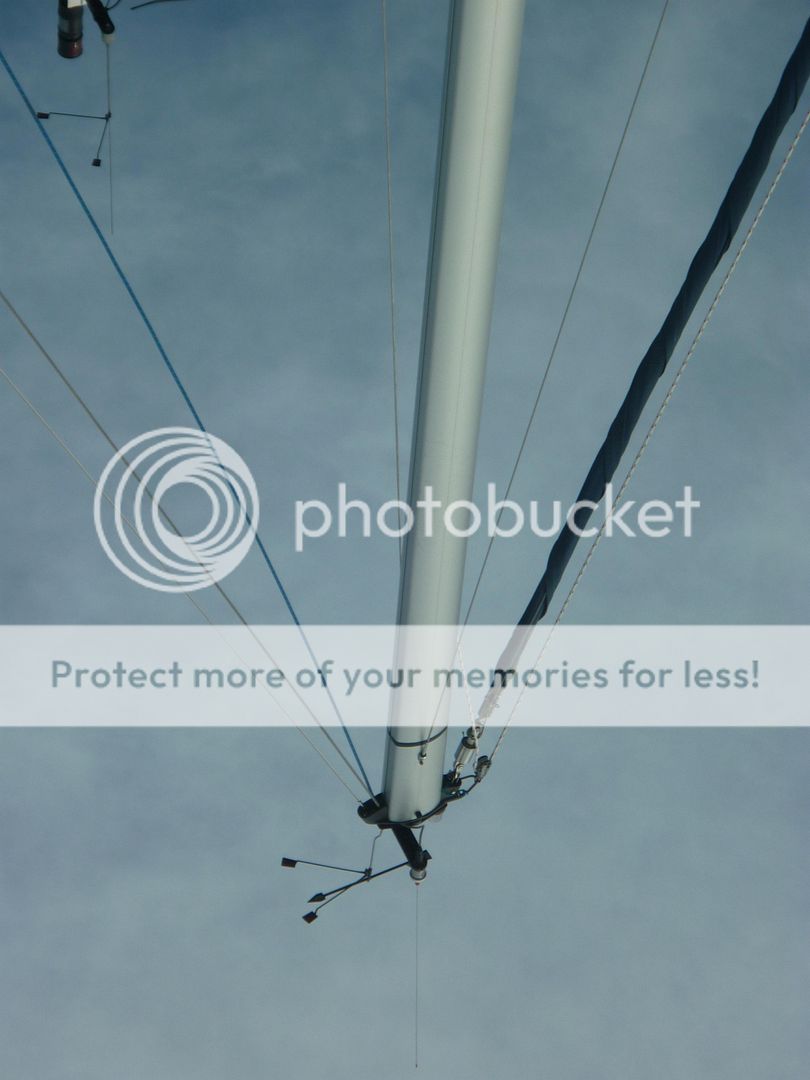

That isn't as close as mine was rigged on the new mast:
When questioned about the halyard touching the forestay the rigger hooked the halyard behind the cap shroud and pulled the block to one side and back so it wasn't touching.
I thought the halyard should exit the mast above the forestay instead of a foot below it.
That's definitely not right. The halyard exit should be offset from the centreline of the mast as should the crane/block attachment point.
As for hooking it round the cap shroud...

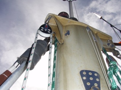

I got a new spinnaker crane made to get a stronger crane with more clearance.
View from the bottom
top view
Spinnaker halyard exit holes (staggered port & starboard)
The old crane.....
