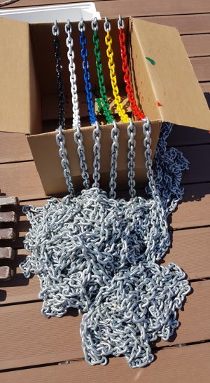

We have tried most methods. The most durable is thin double braid polyester, but this is most difficult to see. We have found the plastic chain markers quite good. Buy a single packet first to check the fit. They should be difficult to insert. We normally need to replace a few at every haul out (every two years) but we are cruising full time so that is over 600 nights at anchor. The only thing to aware of is you spin around at anchor (the same way) and twist the chain you can lose a lot of plastic markers when the chain is retrieved and the twists become confined to the short length of chain between the boat and anchor (we don’t use a swivel), but this is a rare issue.
Techniques that have not worked for us are cable ties and paint. We found these options had limited life for our application, but may be a good solution for those anchoring infrequently or only in softer substrates.

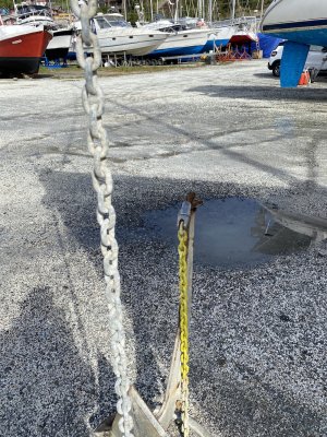

My experience - boat was 8 year old when I bought her. One of the first things I did was replace the chain which was seriously rusted over its entire length.
Present chain is now 30 year old. Galvanising is almost as good as new throughout - see pic - except for maybe 12 inches with light speckled rust which was next to the anchor and is now in the locker.
