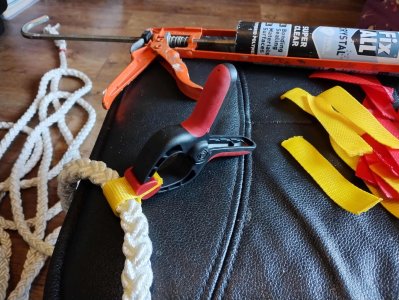

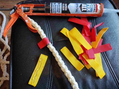

Been getting round to marking my anchor rode and wondered what the best way was to do it. I saw some people spray paint it but I wanted something tactile in case it was dark.
Anyway, I came up with adding webbing tabs. I was going to sew them on but seemed like a lot of effort. Then I spotted a tube of screwfix external adhesive stuff loitering in the garage and stuck them on using a clamp to maintain pressure until set.
Red markers at 10m intervals e.g. one for 10m, two for 20m etc then a yellow one at 5m inbetween.
I'll see how long they last but it seems like a good idea for now. How have other people done it?

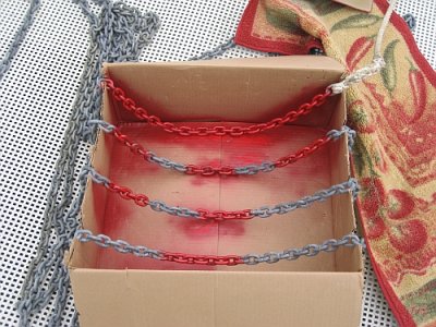

  • Don't over mark the chain. You need a mark shortly before the anchor so that you are ready when it comes up, one at the minimum chain you will ever put out (50'?), and then about every 25-50 feet of so after that. It's not hard to estimate between marks, and it's not a precision business where a few feet matter. I've seen chains marked every 10 feet. It looks ridiculous, but more importantly, it makes the color code or whatever system more complicated. In practice, most boaters only need about 4 markers.
BTW, paint is super easy and neat if you drape the chain over an open cardboard box at each mark, and paint the loop where it is inside the box. Then throw the box away. No mess, no overspray.
