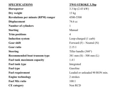

With my Mariner 3.3 2T I can get 6 miles from Totnes to my mooring on a tank of fuel. That is an hour going one up in the dinghy on half throttle on a slow plane. If I go flat out or going the other way against the current I would need to refill the tank just before arriving.Two up the inflatable won't plane and so will use more fuel.
I think all the 2T Mercury/Mariner/Tohatsu variations use the same 1.4 litre tank so you would get about 3 hours running from your 5 litre can.
