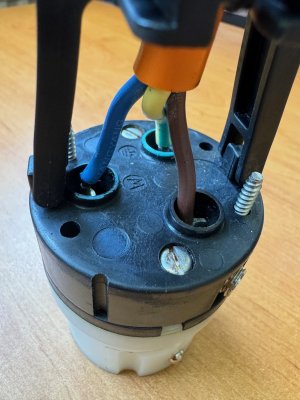

1 Jun 2024 #1 SC35 Well-known member Joined 13 Jul 2021 Messages 2,388 Visit site I have a Marinco 32A connector. Earth is clearly marked with an Earth symbol. One other is marked with a "W" (could be an "M"). The colour coding has sort of faded away on what I think is the live terminal. This is the way it is currently wired up. Is this correct?
1 Jun 2024 #2 N nigel1 Active member Joined 5 Feb 2011 Messages 526 Location Manchester, boat in Whitehaven Visit site 'W' = White. In North Amercian wiring, white is neutral.
1 Jun 2024 #3 Sticky Fingers Well-known member Joined 21 Feb 2004 Messages 6,306 Location Home Saffron Walden, boat Swanwick. Visit site Work of the devil those things.
1 Jun 2024 #5 SC35 Well-known member Joined 13 Jul 2021 Messages 2,388 Visit site nigel1 said: 'W' = White. In North Amercian wiring, white is neutral. Click to expand... Thank you!
