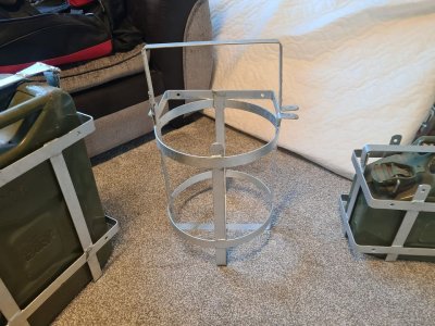

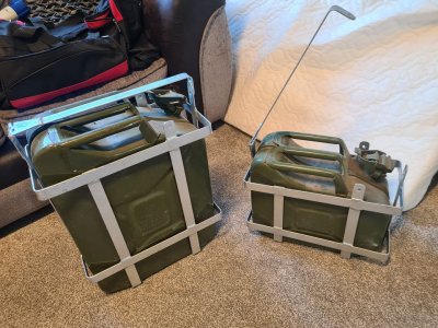

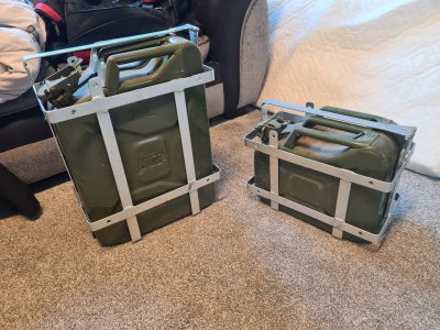

I made and have some left for sale. can send in the UK aswell for £55
they are now galvanised though
