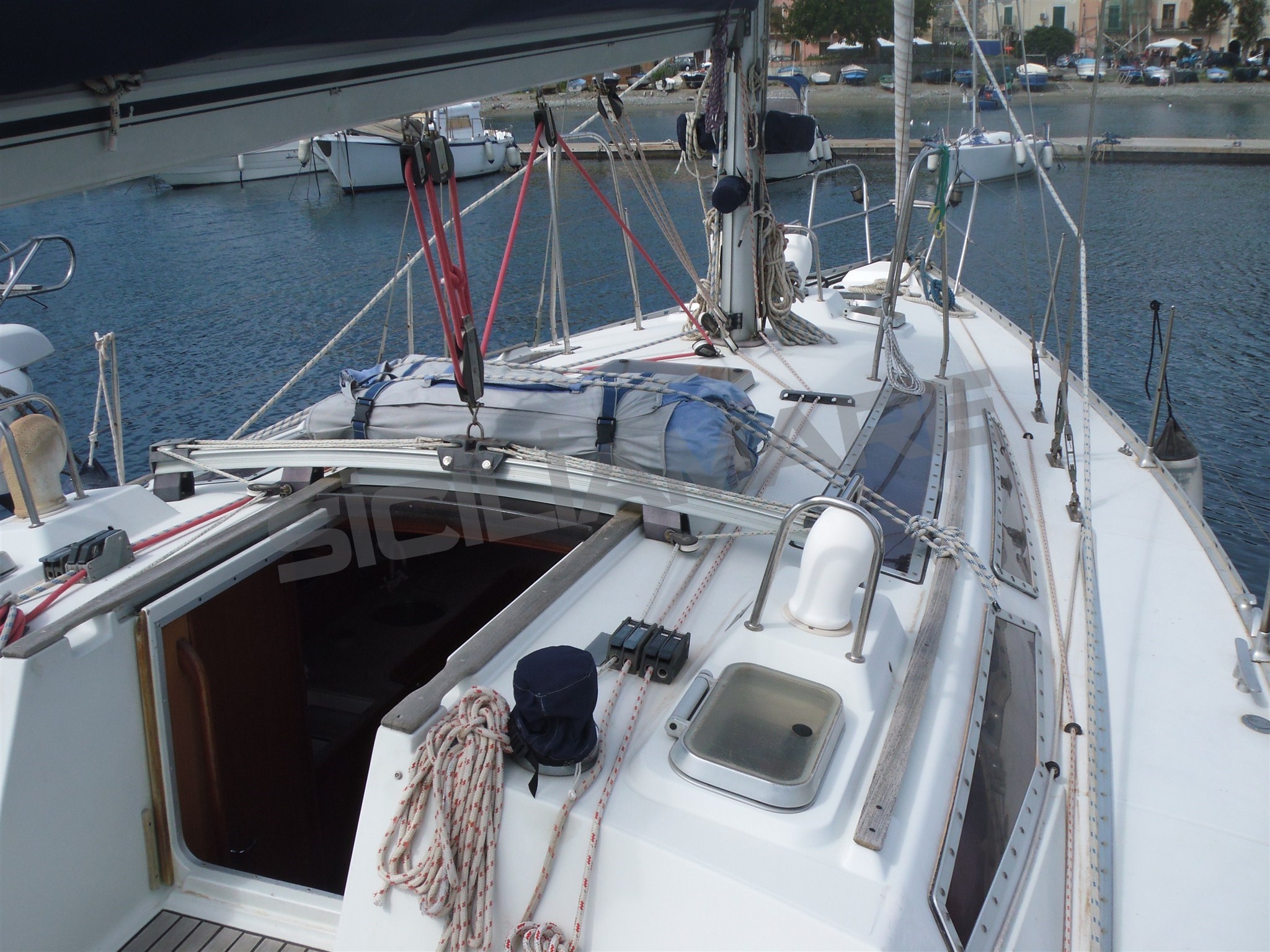

I've got what I think is a totally over complicated mainsheet set up on my boat (pictured) and there's too much friction for my liking and nothing runs smoothly.
The boat is a 42 foot, 9 tonne production cruising boat and any ideas would be much appreciated!
Thanks loads, James

Definitely too much purchase on that, I’d say, James. I’ve tried to clock what other Jen 42’s have and it’s typically a selection of single blocks, not doubles. The only reason I could see for going with doubles would be a ‘German style’ twin winch/clutch sheet system.
Otherwise ours is becket up to single block aft, back down to single block (below becket), up to second single block, down to block on deck. So 4:1 I think. That could be improved upon with the addition of a fiddle block. No need for doubles.
Thanks Dan. I have to say I’d prefer the simplicity of single blocks over a stack of triples and the cost factor of triples is pretty big. I’ll look into this further ??
This was my favourite of the various setups I've seen!
I make this 6:1 vs your 8:1 (although I'm not very good at 'purchases'...!) - so hopefully you wouldn't notice much difference in load. The kids could still sheet in without winches in light conditions!

I just looked at the photos of my 45 foot Jeanneau to check the arrangement. It had a 4:1 purchase arranged as follows: The bitter end of the mainsheet was tied to a boom fitting directly above the traveller. The rope came down from there to the upper sheave of a vertically stacked double block fitted to the traveller, from there up to a single block on the boom aft of the bitter end, back down to the lower sheave on the traveller block and up to a single block forward of the bitter end. Simple and it worked very well.
I think you’re onto a winner here Dan, thanks for that. That set up, but with decent blocks and a new sheet and I think I’ll be in business! Thanks again ??

Looking at the above picture I make it 5:1, because the rope going forward from the traveller is angled well away from vertical and contributes less that the four near vertical ropes. Its a good setup and perfectly adequate. I calculated mine at 4:1 for the same reason. The real calculation is the ratio between the amount of rope pulled through the clutch on the coachroof and the distance that the boom is pulled downwards.
That doesn't make any difference. As you say, it's the mechanical advantage which is important.
TernVI
8 Jul 2020
5,070
The forward block on the boom has the ropes pulling at an angle, so the vertical component is reduced, plus it's nearer the gooseneck.
Even the rearmost blocks are around half way along the foot of the sail, so the velocity ratio is probably somewhere between 2 and 3?
(taking the leach tension as reference).
Our boat, a bit smaller has 6:1 near the end of the boom, muliplied by a 4:1 fine tune.
So, these boats are dependent on winches, so it might be best to look at the system as a whole? What winch do you have? Does having lots of VR in the block system make it better to use? Unless you have a very low factor winch, is the whole system too complex? Or is it nice to use in light airs without a winch?

It’s not too difficult to do a ‘German’ system conversion on these. There are a decent sized pair of aux winches aft and space for clutches etc. But it does mean a lot more lines running around the place. Guess it depends how ‘active’ the sailing is and the crewing situation? For ours, I don’t think we’d make enough use to justify it. The cockpit isn’t huge - although the wheel is (trapping the helm the wrong side of the coachroof lines!).
That's only a 4:1 purchase, if you find that practical the OP may well be in the same position; it's worth rethreading the mainsheet and trying it out to see what it's like with the existing blocks. And definitely check the block on the deck by the mast foot; if the sheet is rubbing on the deck leaving the block that will cause a large friction load.
