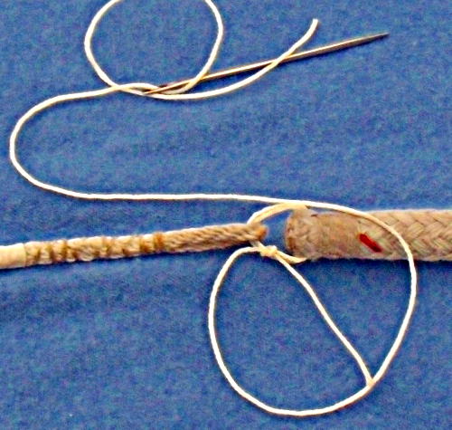

For safety's sake I would sew the light lines to the topping lift and halyard rather than just taping them.
If the mast is to be taken down, surely a fish tape is the way to go? Having discovered that tool, I have used it in various tasks on the boat and mast.
Or stitch loops on the ends like this:-
