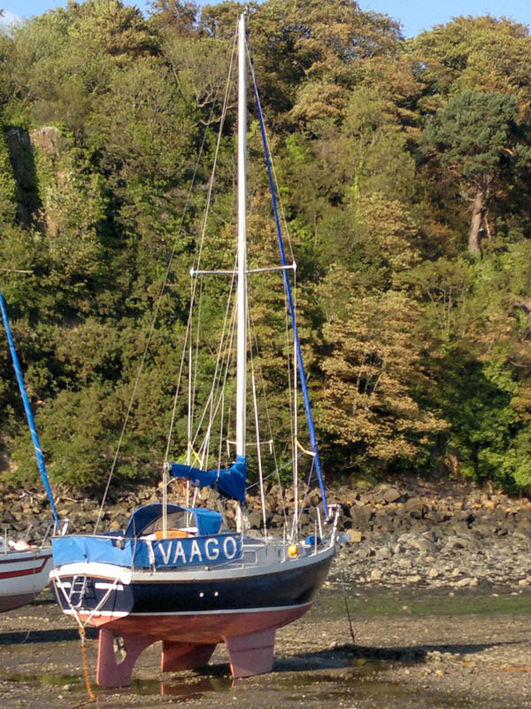

All the keels that I've seen look like the one in this photo. As I understand it... the original encapulated* stubby keels, clearly visible in this photo of a MkIII (see below) were extended (the dark line shows the join). So as a layman to a certain extent you might argue that 27's have both types of keel *. NOTE: Apparently my understanding as stated above is wrong - please see Nicholas123's comment below.
I'm not going to speculate on the tech/spec side of things, I just thought that a photo might help forum members see the issue.

we have several Macwester in our club and from what i've seen the 26 and 28's have encapsulated keels and the 27 has bolted on cast keels.

The photo you have posted shows a cast iron shoe bolted onto the hull molding.God only knows where you are getting the idea from that there is anything encapsulated about it!
Nicholas123: Please look at the first line of my comment I said "Like Jcorstorphine I could well be wrong here".
I made it clear that I don't own a Mac 27. I'm no expert, but like most in this forum I'm only trying to help with what limited knowledge I have. It's the process of crowd-sourcing of knowledge (that inherently includes misinformation) that makes forums a valuable source of information for members seeking help.
I was referring to the 'hull molding' when I mentioned encapsulated ...because as a novice/layman I understood the hull molding included an encapsulated keel/weight.
I shall edit my original entry to point out my error.
You response to a previous posting by Yodave is out of order and I for one will not bother to help you with any information in the future.
I don't blame you for your assumption.The Lazy Kipper who said he owned a Mac 27 stated categorically that his Mac 27 had encapsulated keels.I have yet to see any evidence that any of them had that is all.
In actual fact I went & had a look at two Mac 27's on Sunday & was struck by how thin the fiberglass was around those keel stumps & also by the fact that they were obviously hollow.Something quite surprising to me considering their exceptional displacement.
Maybe there are Mac hulls out there that were molded with ballast built in but if that is the case then there are two radically different designs.
No offense intended.Sorry if I have caused any.
