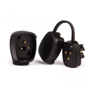

I need a replacement waterproof deck socket and corresponding plug. It's to connect the ram for the autohelm. The current socket is crusty and has suffered water ingress at some point. Although the existing plug and socket combo is three pins, only two seem to be in use so I am guessing a two pin socket will suffice. A like for like replacement is stupid money -£60 which rubs up against my sense of being ripped off 🤔. Current plug and socket look like the ones below. Any recommendations of something that is actually waterproof. This one isn't really.

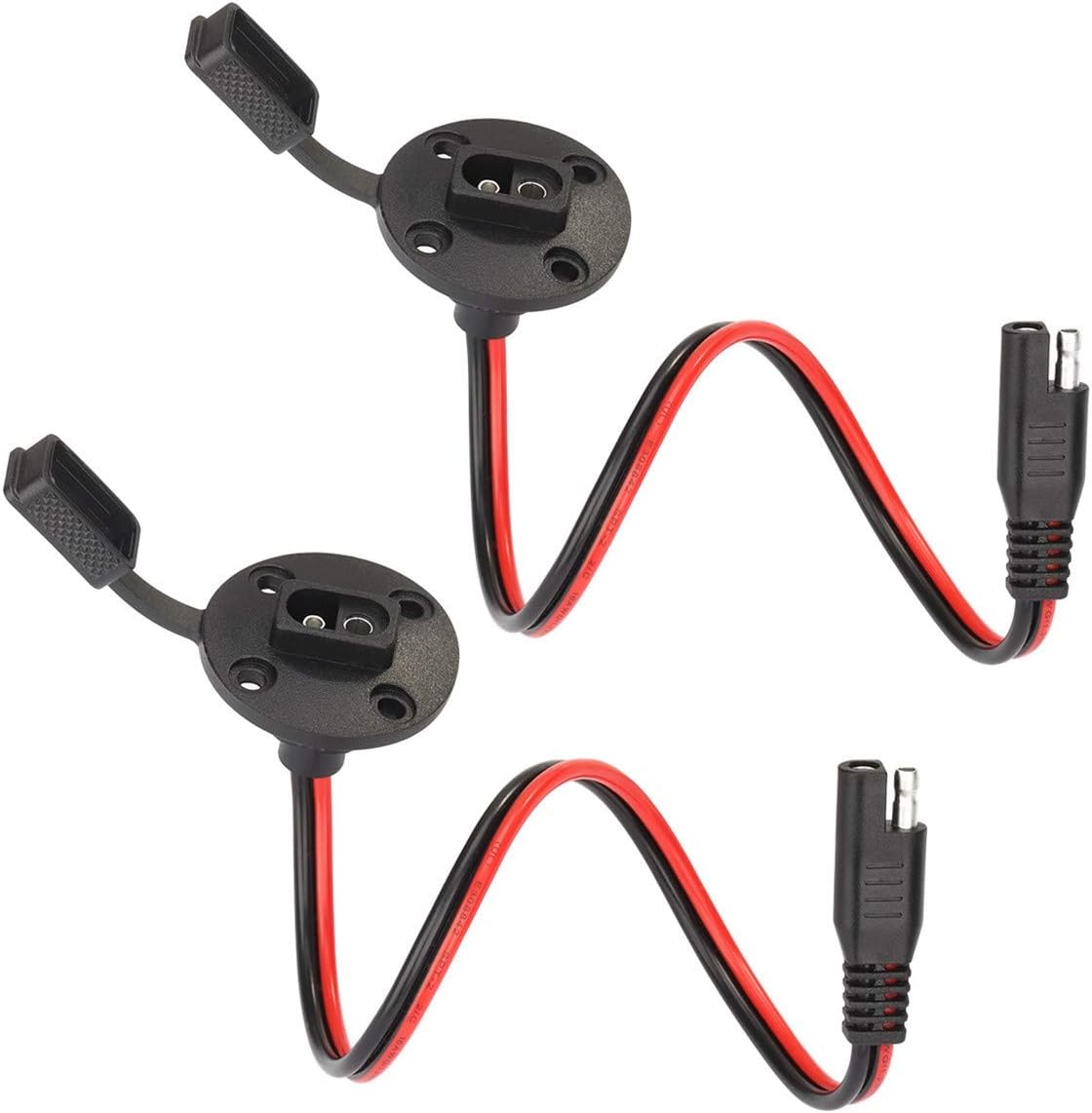

SAE 2-pin bulkhead. Waterproof. I get at least 10 years out of them if I grease them every season. They are now my standard 12 V plug, and I've been fighting non-standard for 40 years. $11. Very widely available in the US (any auto parts store + Amazon).
Hint: you cut the wire in two and splice one half to the 12 V system and the other half to the device. In fact, my tiller pilot runs on one of these, after facing the same dilemma the OP has. It's been two years.

The SAE sockets are hermaphodite and can be wired and plugged either way, but it is best practice that the exposed pin is ground and the socket pins are hot. Not a big deal on boats in all cases, but important on motorcycles and cars. They are also available in 4-pin version, that formerly was widely used to connect trailers and caravans. The 2 pin can actually plug into the 4-pin fitting and works, so long as the pin is ground and the first socket is 12 V hot.
Polarity is vital for most things now that LEDs are the most common light source. Most of you know that LEDs do not light with reverse polarity. Same for anything with a chip. So get it right. If you don't know how to use a multi-meter you should learn or contract electrical work.
In the US extension cords, adapters, and accessories with these plugs are common. Just remember the grease. There is also a cover attached.
