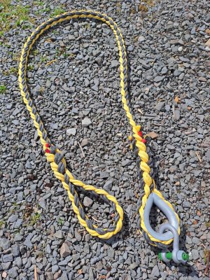

By coincidence I just made up a new strop, shown below. It's 3m long (I used 4m of rope but I put two splices in it) and is 28mm diameter 8-plait 'Polysteel', bought from Boat Gear Direct. It's way over the top for the OP's needs, being for a 42' boat weighing >13T, and presumably with a higher bow fairlead. So a 2.5 metre strop sounds about right for him.
I don't like having more than one line as I doubt the safety advantage. The breaking strain of this strop is 13,540 kg so it's going to fail by chafe it fails, and two thinner lines would chafe more quickly than a great fat rope, so I think the benefit of a back-up is illusory.
