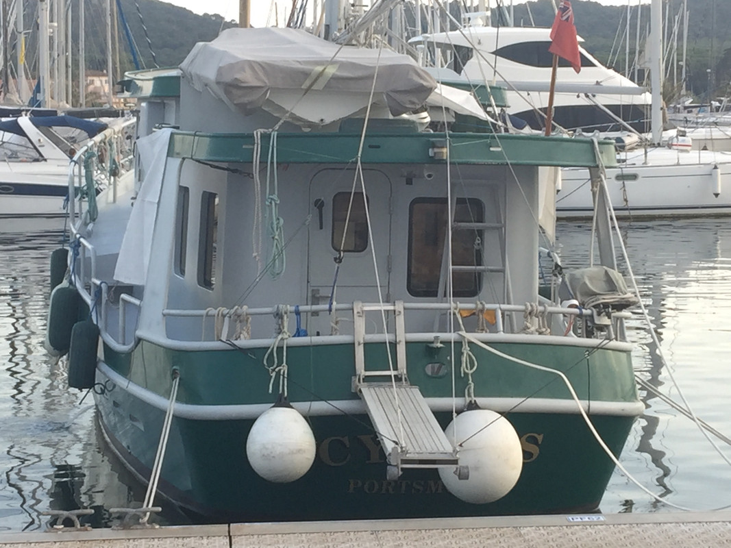

I later came across this boat with a similar set up....he also had a lot of rigging, and he has attached the passerelle to the boat much more sturdier...helps that he has a metal boat

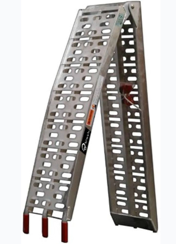

One of things I used to use was a folding aluminum motorcycle ramp....cheap, light weight and strong
Who's laughing? It looks a lot more robust than a lot of the gangways I've been looking at, and a fraction of the price. If there was a way to attach it to the swim platform I'd be interested too.
Use something like a rigging toggle attached and the pin drops through a 'hole' in the deck, a bit like the one in your first post.
