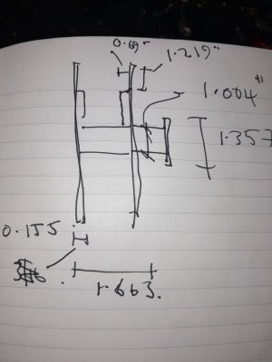

The pulley appears to be in two parts, screwed together. I've left the cover off so any more details needed, let me know.
Ian, do you know the diameter of the tube? I can make up the ss bits for 3sp and get them over to UK in a couple of weeks with a passing friend.

There doesn't seem to be any tube as such, but the black part of the fitting is 1.004" diameter. Mine has the wire proud of the whole fitting and a SS flange, which is not original.

I have just had a look at the Kelt and it is the same H-A part! The tubular shaft is 20mm, or poss 3/4 inch, I will take a caliper out.
Offer still open to run up a shaft and get it to you end of April. Cost of postage.
DW
Edit: The tube is 19mm/ 3/4"
