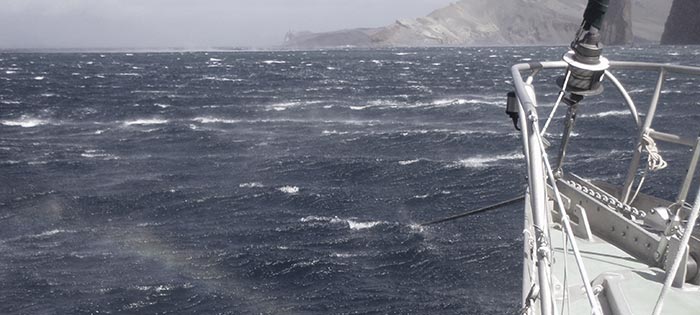

In conditions like this, I think you would be glad that you got a bit more chain than the minimum you thought you could get away with...
