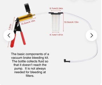

When using a vacuum hand pump on a brake bleeder, the hose should trend vertically from the bleeder and so you can view an interesting process while pumping gently. Initially this is just air as the filter fills. As fuel and air (mixed) emerge up the tube, the air separates and the fuel component descends. Bubbles keep emerging but the liquid does not want to climb until there is almost pure liquid behind it. When fuel starts to steadily climb the tube you are basically done and can close the bleeder valve. Now you can disconnect the pump and tilt the hose down to a jar to drain anyremnant fuel. There is always some air leaking past the bleeder threads but that is no concern.
You could use a large suction syringe as Ducked alludes to (which would need two hands) instead of vac pump — without it getting wet and some folks use an oil change vacuum reservoir, allowing it to get wet. There is a YouTube video showing that with just a plug removed from the secondary filter; search “bleeding a Yanmar 3GM30”. it works well because the lift pump acts as a check valve, but he apparently skipped bleeding the primary or the injection pump inlet. Not good enough for me.
In the photo below I show a vacuum pump with a liquid collector reservoir but as I described above, that is optional if just servicing the filters. Using vacuum there is no chance of fuel spurting.
