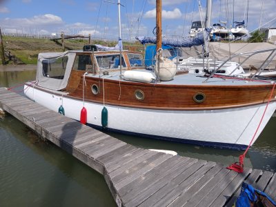

Thanks to Tom at Tollesbury Marina my Buchanan 24 starts to look good
Yes it is a Buchanan 24, I have the original order, correspondence, drawings
and specifications.
Isabel and I enjoy the pleasure of owning and sailing this beautiful craft
The papers I have indicate there were 4 of these made, Skye was a work boat for
an environment agency in South Wales originally.
The specs make provision for a Mast , great and stable under sale,
stately is another word for her
