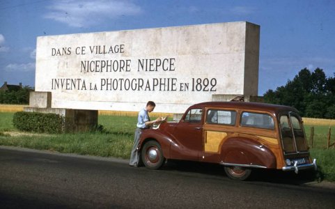

My father started out as a pattern maker in Denny's Shipyard making the objects in wood that were later cast in metal.
An example of his handy work, this was originally a saloon car and he put the woody back on it, pic was taken in France in 1954
Nice work.

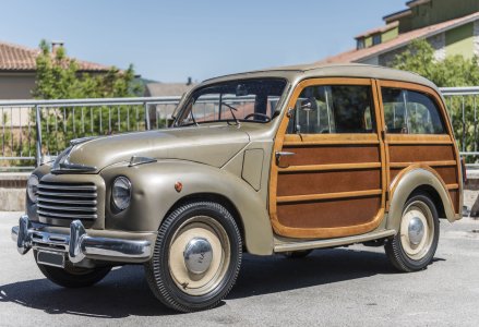

This reminds me of my first car in the fifties: The Fiat 500 "Topolino" (little mouse) C station wagon that had wood and masonite panels.
Not my car photo. Mine was much more battered.
