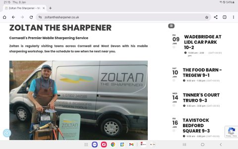

But a steel will gradually degrade the blade. Modern ceramic sharpeners don’t do this so no longer require the knife edge be reinstated occasionally as used to be the case. I remember a man in van doing rounds for exactly this reason many years ago.
