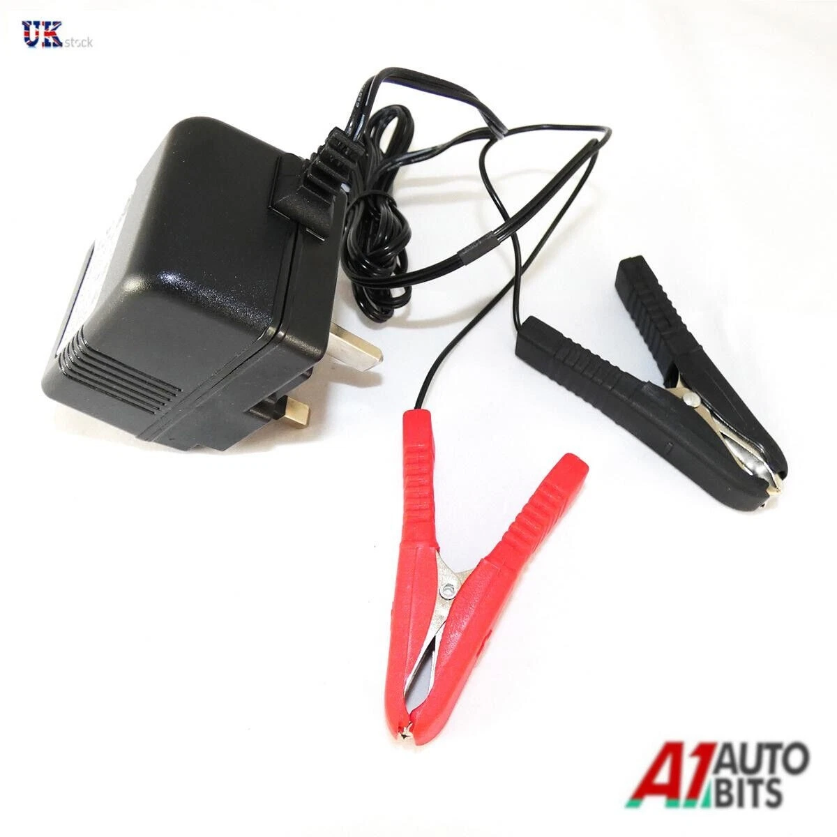

That link is for a 230v AC to 12v DC 0.5A adaptor. It is not a trickle charger and is only current limited by it's own design limitation. The float voltage of a lead acid cell is 13.8v which I doubt this adaptor will provide. My guess is it will sit doing nothing until the battery voltage drops below 12v and then it won't have sufficient clout to top the battery up anyway.
The seller has just bought cheap AC adaptors that happen to be fitted with battery charger croc clips. Don't waste your money.

I have been using these as maintainers for years and they have been good.
If you have never used - I suggest you test before making such sweeping statement. They are purpose designed as maintainers ... by virtue of low current supply.
What I found was that they kept the batterys to sufficient level such that later when battery was to be used - a quick charge with a full rate charger to top off was more than sufficient.
OP was asking how to keep a battery for long period ... these do just that ...
I am a qualified electronics engineer. I can guarantee that a cheap 12v adaptor will not maintain a battery or supply any current if the battery is healthy when connected to it. I don't need to try it because I know it won't work. It may be your batteries would have done just as well with nothing connected to them and the effect you witnessed was confirmation bias that the things were doing a good job.
On the other hand my CTEK MXS 5.0 does a perfect job as it was designed to do, but then again, it costs £75.
Edited to add, I just went to check a couple of things. I have a 12v 1.0A ac adaptor. I measured the open circuit voltage at 12.2v then loaded it up to it's rated power (12 watts) using a 12 ohm resistor. Under full load the voltage dropped to 11.9v (top marks for the adaptor working as it should). I then connected the CTEK to my car and the open circuit voltage was zero (the charger needs to detect a load before it works). Connected to my fully charged car battery, I saw it delivering 12.8v to the terminals.
