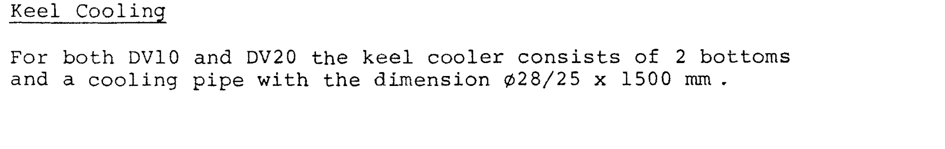

The dimensions given in the DV10 and DV20 workshop manual are a little confusing. The diagrams only appear to show a single pipe. Maybe 'bottoms' only means the pipes running down to the cooler
In the same ball park? Cross sectional area for the twin pipes is 568 mm2 and for the single, it's 490. The twin pipes are for a more powerful motor, I guess the twin pipes would have more surface area, too. I got the info from the Bukh user's manual for the DV24. I dallied with the idea of buying one of those ex lifeboat engines from India!
