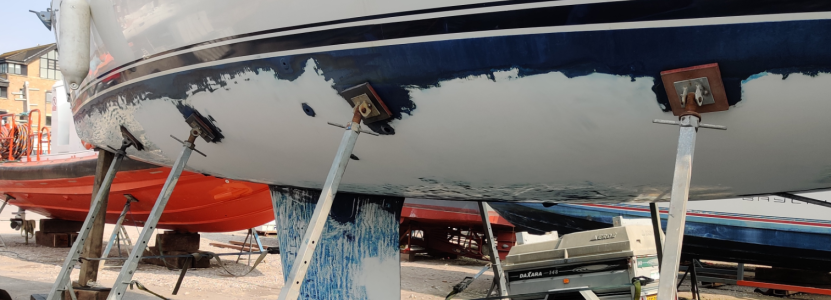

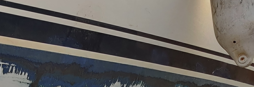

Hi,
Our bootline has some damage and the boat is currently on the hard. Ive just spent 5 days scraping back 24 years of antifouling and am about to redo it. The boat has 3 lines all the same blue but only 1 is damaged in several areas. I was hoping to replace this. I have been quoted £662 from a Jeanneau dealer in the UK. Ideally wanted to get this done while im doing the other jobs out the water.
I have contacted a couple of local sign shops who can do the vinyl but they would need to know the colour code, ideally the RAL colour.
Im hoping with them being a production boat they will be the same. Does anyone have this code or a very close match?

I have been patching the scrapes on our SO 37 with a dark blue that came off Ebay IIRC each winter for the last few years. I dont know the exact colour, and its not identical but from more than a few feet away you really cant tell. IMHO if you are replacing the lot a Navy blue would be fine. I notice that the line is not the same width all the way round and to do it properly you may end up with the high quote you have for the exact spec and shape.
Edit. I'm pretty sure having read post #9 I use the PSP coveline tape in Dark Blue

I wouldn't bother with the codes, Coveline tape is generally available in only a few colours and I strongly doubt Jeanneau got a custom one made, it's not the way they operate. Even if they did, how would you get a custom colour made up?
Ebay and Amazon will sell you some extremely cheap, and Marinesuperstore have the quality PSP stuff which Jeanneau probably use for not much more. They only have dark blue and royal blue so my guess is yours is dark blue.
Coveline tape is sold under different names depending on industry. Boot top, Cove line, coach line, pin stripe, vinyl stripe are all the same stuff.

You will be amazed how poor a match you actually need. from a distance it's very hard to see.
Our navy boot stripe (also on a Jeanneau, but I don't think original) had loads of light blue touch ups that I had never noticed until the gaps started to bother me. You can just stick bits over and it can be quite hard to see.
For thinner stripes, only patch covering both sides. Use a wider piece and press a flexible metal ruler along the stripe edge and run a blade along the top and bottom edges to make it fit.

Just in case anyone is looking for the colour code, I had a response from Jeanneau
'For the part number : 976827 the colour is "Blue 50-90" in 3m adhesive, corresponding to Pantone 648C, which is very similar to RAL 5013.'
